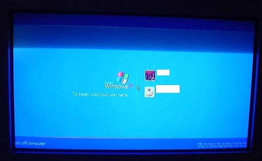

I've done a lot of lurking around on message boards regarding hooking up a PC to an HDTV. I finally got it working (sort of) on my home system, so I figured I'd stop lurking and actually contribute. The relevant components: - Sony KV-30HS420 HDTV. This is one of those wide-screen CRT televisions. It has an HDMI input on the back, although it also has regular analog audio ports next to the HDMI input, which is fortunate. The HDMI input is capable of displaying 1080i, 720p, 480p, and 480i. - PC with an nVidia GForce4 Ti4400 I found online and ordered a DVI -> HDMI convertor cable. I read that HDMI and DVI are almost the same thing, except HDMI also carries digital audio on the cable. The cable ran me about $30, I think. The first time I hooked it up, I got absolutely no picture at all or anything to indicate that the signal was even getting to the TV. I tried again a few weeks later (because I *knew* something should have happened) and this time it came up on the first try. I think the difference was that I had the cables all hooked up and the television on when I turned on my computer. This was almost certainly because my video card tried to auto-detect what type of monitor it's hooked up to. The initial screen resolution came up at 1024x720. I figured this was optimal because the highest non-interlaced vertical resolution the TV could display is 720p and I'd rather have slightly less resolution than interlaced video. I was quite ecstatic until I realized that the TV wasn't quite displaying the whole picture. It looks like the outer 50 pixels all the way around we being hidden. I've attached a picture I took of the TV to this post so you can see what I mean. It looks complete at first, but you'll see that the "turn off you computer" part is clipped off. After logging in, the Start menu isn't visible and the "My Computer" icon is just off the screen. I tried adjusting the resolution all the way up to 1080 pixels tall thinking that maybe switching to different resolution might cause the TV to draw the whole screen, but that didn't work. The picture wasn't drawn correctly and was "flickering" after changing and after rebooting, the resolution reverted back to 1024x720. At this point, I'm guessing that the card recognizes that it's being connected to an HDTV or at least a monitor with HDTV-like resolution, but the TV isn't displaying all the picture it gets. I know that normal analog TV has part of the picture that isn't normally displayed so I'm wondering if the HDTV picture has the same "problem". I'll continue to play with it and post a followup if I get this problem fixed.

| Posted on Monday, November 08, 2004 - 07:17 am: |
Nice little tutorial! Keep us posted |
Unregistered guest |
| Posted on Tuesday, November 09, 2004 - 10:18 am: |
I believe you need to use powerstrip? Check this guide: http://www.htpcnews.com/main.php?id=powerstrip_guide_1 I'm getting similiar hdtv and would like to know how this works for you. Brian |

Found this on the Nvidia web site... might be usesful as well Component Out Y Pr Pb ForceWare Release 60 supports outputting SDTV, EDTV, HDTV formats over analog component out Y Pr Pb on GPUs with the compatible connectors*. Users can select the format for their television (480i, 480p, 720p, or 1080i) and output in stunning clarity. In addition, NVIDIA offers users correction modes to solve the problem of the Windows desktop overscanned and cutting off the Windows Start Button. The first method, underscan, works by centering a lower resolution on the HDTV screen. For component out, NVIDIA determined through market research that 15% overscan is common with many TVs (both SDTV and HDTV). NVIDIA used this information to create two custom resolutions that are optimal for Web browsing, running applications, and playing games on HDTV sets. These resolutions are: * 720p: 1088 x 612 (85% of the full 1280x720.) * 1080i: 1600 x 900 (1632 x 918 is 85% of the full 1920x1080, but that is so close to 1600x900 that 1600 x 900 is used instead.) The second method, overscan shift, works by tracking the position of the mouse cursor and slightly shifting the display when the cursor starts to become close to an edge of the desktop. This mode looks just like “native” HDTV mode (720p, 1080i) because it runs at the full HDTV resolution, which causes certain elements of the desktop – such as the Start button and the clock – to not be visible to the user at all times. But as the mouse cursor gets close to these desktop elements, the NVIDIA driver intelligently shifts the desktop a little in order to move those elements into view. The third technique, native mode, has where no overscan compensation done in order to give the user a true cinematic experience. This is useful when the user does not want any pixel compression (squishing) and does not want the mouse to shift the desktop. The table below illustrates the use case of these corrective methods. Use Case Recommended Corrective Method Reasons Watch movies Native Underscan correction always reduces the quality of the video being watched since it changes the size of the native video resolution by compressing the size of the pixels. In addition, sometimes there is additional electronic information recorded in the invisible portions of the video stream. This is not supposed to be seen directly by the user, as it can be very distracting. Underscan or overscan shift would cause this information to now become visible. Browse the web Overscan shift Underscan Browsing the web requires that the end user see all information in the browser window. Either of these modes will allow the users accomplish this and provide the best web viewing experience. Run Windows applications Play full-screen games Underscan If the application correctly queries the graphics driver and requests the modes it supports, the end user will be able to play the game in the corrected underscan mode and see all of the information on their display. However, some games do not query the graphics driver. Instead, these games hard code the resolutions supported in the game directly into their code. Therefore the end user must find an alternative way to correct the resolution, like checking the display for correction options. For more information on configuring Analog Component Out on your graphics card, please consult the section Configuring HDTV in the ForceWare Release 60 User’s Guide. http://download.nvidia.com/Windows/61.76/61.76_ForceWare_Release_60_Graphics_Dri vers_Release_Notes_Windows_XP-2000-9x-NT4.pdf

Derek - Very nice article. I ran into the same problem flicker/clipping of regions etc. I have Nvidia NVS280/ Sony WEGA 27 inch. I used Powerstrip and set my resolution to 1280 x 720 and things look much better now. I found this article on Powerstrip which could potentially improve things! (I am still learning so I don't have much to add) http://www.ramelectronics.net/html/powerstrip.html (This is where I got my DVI-HDMI cables, they are very nice people!) |

Hello. I have a Sony 30" widescreen (KV30HS420). I'm using a Radeon 9600 XT, and running DVI out to HDMI in on TV with a converter cable. It is running at 1280 x 720, but with some overscan. Has anyone made progress on this? Every time I try to do something with powerstrip, the TV goes black, then it eventually comes back on, but with no adjustments. I'm hoping some one can figure this out and give me some help. So frustrating to be so close, yet everything is just a little off! Also, I don't even have any 1080 resolutions available to me. Seems like this shouldn't be so complicated. Any advice?! Has anyone got this working correctly on a Sony widescreen yet? |
| Posted on Tuesday, April 12, 2005 - 08:23 pm: |
Hi Sledgeweb, Download ATI's CATALYST Control Center NOW, it will easily take care of your overscan problem with Radeon series of Graphics card. http://www.ati.com/products/catalystcontrolcenter/ It allows you to set a customized resolution like 1100X680 that will make all your desktop visible!
