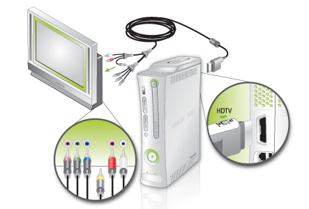

i have an hdtv ready t.v. and i have an xbox 360, am i able to buy something that i can get to play my games HD without geting a big expensive tuner because i dont realy want to watch hd tv, jus the games |

Use the cable that came with your 360:

no no, i know that, but i have a hd ready t.v., and in the front it only has 3 outlets, and the hd wires have six, is there something i can buy so that i can play hd. because i dont want a tuner. and in the front of my tv where it had the 3 outlets, next to it it has another different outlet so i can plug something else in. get it? |

"and the hd wires have six" No, HD wires, or at least the red-green-blue component wires pictured above are only three wires. All HD ready TVs have at least one set of these three-wire component inputs made to utilize the component signal coming out of your xbox and other HD devices. That is all that is required for an HD picture. They also show the red-white wires being used for the sound. If your TV does not have a component input, it is not an HD ready TV. Get it? |

ooo, ye i see, i jus checked the back of my tv and there was green blue yellow red and white, so if i hook my 360 up to it it would look like im playing on a plasma t.v with the same quality? |

"ooo, ye i see, i jus checked the back of my tv and there was green blue yellow red and white, so if i hook my 360 up to it it would look like im playing on a plasma t.v with the same quality?" Since you have not specified your TV's model number, I can only promise HD quality if your TV has a component (RGB) input. But with a component input, it must be said that even that does not guarantee HD quality video. There are TVs with component inputs that are not "HD ready." |

i have a samsung LCD TV LA32R81B that is hd ready. But i cannot play my xbox 360 games on high definition. please help!? |

shiv, you must have a proper component hookup to the TV from the xbox. That hookup looks like this.

hey, i have already tried to connect the way you have shown above, which i got from from the xbox360 website. But even after this blue screen appears on tv. |

First, I am assuming you have selected the appropriate component input on the TV. Second, you must select "HDTV" on the connector, as the diagram shows above. Third, you must select hi-def output in the "System Area" on the xbox dashboard. If it gives you a "720p" option, select that. |

i have done all these things....but the hd option is not highlighted on the xbox dashboard because of which i cannot select it. Do i need some other external tuner for my HD ready TV? pls guide! |

Are you trying to play an older (pre-360) game? Does you xbox have a hard drive? |

No i am only playing xbox 360 games of pal version and my xbox 360 has a hard drive. all the games are new and are working on standard definition. the thing i want is to play them on High definition on my samsung LCD TV LA32R81B that is HD ready using a component hd cable but im unable to do so even after connecting. |

go to system, console settings, then display, hit on HDTV setting, then spank it into the setting you want, if everything is a go it will show as a current setting on display like, current setting 720p wide screen standard, for the cable xbox give you the crappest cable they could supply, theres a switch on it for high def that you might have to giggle back an forth real hard untill you break it into a permenant position, then go to bestbuy and for $50 you can buy the cable that should have come with it, and buy a optical to plug into that, dont buy the moster version or you will end up spending money on there stupid optical adapter unless they finally fixed that, if you have everything hooked up right you should notice a huge improvement on your display menu, it wont look grainy any more it will look very clear, if your getting a blue screen then the signal is not getting threw, or your not selecting the right one on your reciever or if you have it direct to your TV then on that, hay john whats with the green high light thingys, its getting real irritating everytime my curser tuches them, I didnt notice them before? |
