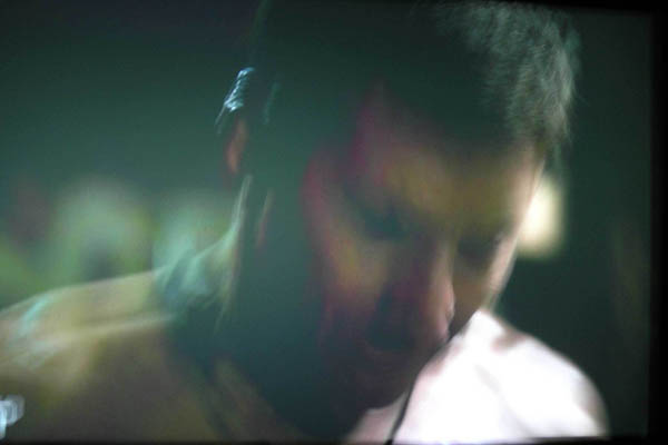

Same exact problem my HLR5067W has been doing. It's back to being fairly intermittent. Only does it mainly after having tuned the sat box to Equator and when using the Wii occasionally. It fixed it for a little while after I finally opened up the back of the TV (unplugged of course), cleaned all the dust out, then re-seated all of the wires that connect to the input board. We just bought a new lamp for it too
Anyways, we're going to solve the problem after we move in a couple months by getting a new 55" Sony A2020 and moving this thing to bedroom tv status as it doesn't have probs on normal broadcast quality signals.

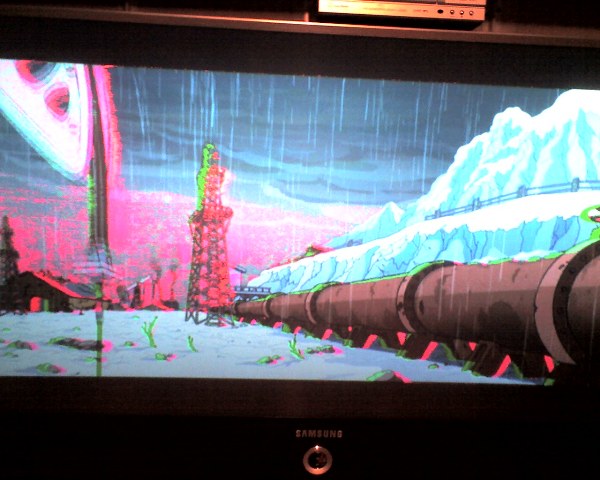

any ideas how to calibrate the picture on a hlp4667 dlp rear projection tv changed color wheel and now get the distorted picture on darker areas like fred in earlier post
Username: Gs1344
I had the same problem, and this proceedure cured it.
You need to syncronize the new color wheel to the original digital board.
1. With the set off, press “mute,1,8,2, power”
2. Select “DDP1011?
3. Select “INDEX DELAY”
4. While changing the index delay value,look at the horizontal red bar at the bottom and make it look as close to true red as you can.
5. Select “OPTION”
6. Select “USER RESET” to save,tv will turn off automatically.
7. Turn tv back on and check color quality.

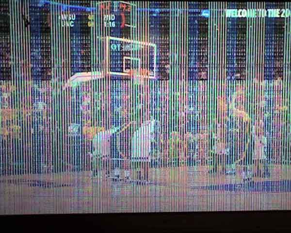

From a review of the boards, it appears I've got the dreaded frozen black and white picture that many have dealt with here. Pushing and holding the power button seems to reset everything. Sometimes I will get lucky and the tv will work for an hour, sometimes only minutes.
I'm the original owner and with 3 1/2 years under my belt, I'm way out of warranty. It's time to bite the bullet and get this fixed. Per the posts, it sounds like I need a digital board. I've got a 50" Model # HLN507W1X, but when I go to Samsung parts online, the closest thing I can find as a match for the part is 'ASSY PCB MISC-DIGITAL.' Is that the part? What's the difference between it and the 'ASSY PCB MAIN-ANALOG' counterpart? Do I need both?
Because just one of those parts is an over-$300 prospect, I'm wondering whether there is any other source for these digital boards? Also, is this a pretty much plug and play repair? (I opened the back panel and I'm hoping the digital board is that metal thing right in the middle.) I'm not at all experienced with these things, but I don't want to shell out the money for someone else to do it. Seems that if I pay someone, I might as well consider getting a new tv for the cost. Both options really stink considering what I paid back in the day.
Thanks for your help everyone (especially FYI--couldn't help but notice your helpful posts!). Sorry if I sound bitter here, I just don't want to throw good money after bad (but at the same time, I want to save money where I can). Any advice on the above is appreciated. Thanks again.

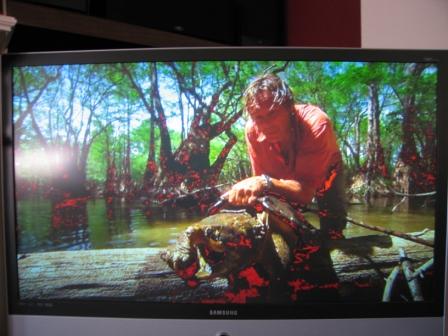

The white pixel death need not immediately require a new DMD board: Turn your TV off then, using remote, type in MUTE, 1, 8, 2, POWER. Then switch your GAMMA to 4 or 3 and turn SLR off.
It worked for me. No white pixelating snow from frozen hell now. Going on 128 hours straight. Also, adjust your INDEX DELAY to 223 or something. I think I'm starting to crack their evil code now!}}}
