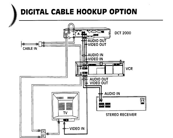

Username: Dougq
BC
Registered: Apr-05
Gillie and all, attached is the diagram of how I resolved this problem. It is essentially what Gillie states. When you program the vcr if you want to tape a digital channel you set the digital box to that channel and tape from the aux inputs. You can then throw the switch and still watch an analog channel on the tv.Upload

Username: Xray
<can someone please help me to try and figure
<out how to figure out how to connect my vcr
<so that i can record from my cable box.
You will need an a/b switch and a splitter, but it will need to be hooked up a little differently than in Doug Quance's illustration.
You will be able to record all analog cannels and watch another analog channel at the same time when the switch is switched to "A" but you will not be able to watch digital channels.
You will be able to record all digital and analog cannels when the switch is switched to "B" but you can not watch another channel at the same time. To record a channel while switched to "B", the cable box must be on the channel you wish to record and the VCR and TV on channel 3.
Here is the set-up:
1. Cable line to splitter.
2. One side of splitter to "B" side of A/B switch, the other side of splitter to "cable in" on cable box.
3. "A" side of A/B switch to "cable out" on cable box.
4. "TV out" on A/B switch to to "VCR in".
5. "VCR out" to TV.
Username: Xray
Correction on my last post:
Those instructions are for being able to watch analog channels while taping another analog channel.
If you don't mind having to watch the channel you are taping, you don't need a splitter or A/B switch.
1. Cable line to "cable in" on the cable box.
2. "Cable out" on cable box to "VCR in".
3. "VCR" out" to TV.
