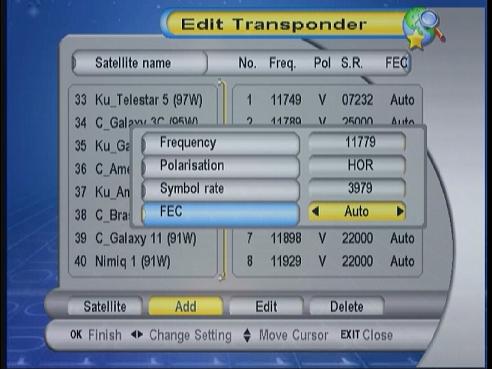

These are the setting I use for 97w (cw600s)
With dishpointer dot com , set up the map for your dish location , aim as shown and adjust elevation till you get good quality

When aiming the dish make sure in your antenna settings that you have selected an active transponder, you could use this site to ensure that the TP is active.
www.global-cm.net/MPEGlistKuBandUS.html
or use 11779 H 3979 for 97w

try it with this TP 11779 H 3979-
you might need to add it.

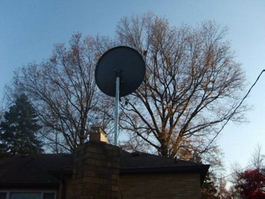

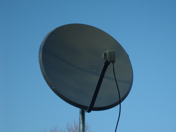

Here are the pics i took for my dish and LNB.

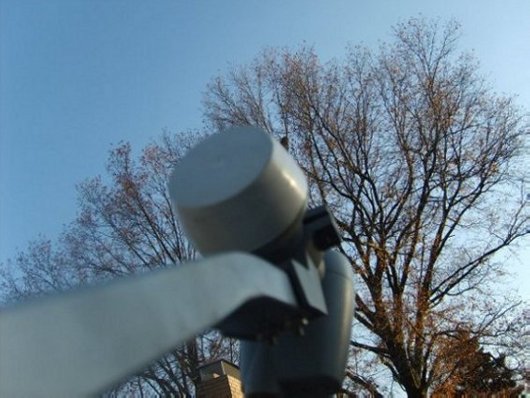

Plymouth, here are the other pics I took.Upload
For whiskey, I am not using a compass and using 196.7 and elevation 42.5 but still no quality. By the way, I am not too worried about troublemakers since there is nothing illegal about true fta.

It seem that your dish is in direct line with the big tree on back of the picture.
I'm not able to found your LNB type!

Your dish point on red circle

Well Plymouth, my dish in the picture is actually pointing to the true south. When I move it to the west(right) to try to get 97w, I get no quality. The reason I left it pointing south is because I got tired of messing with it, so the true south will be my reference point when I try to point it later. Do you need a better picture of the LNB to determine what type I have??
Username: Plymouth
Post Number: 11564
yaser
Yes if you can take a picture of back LNB, it will be easier to found the Model.

Yaser I can assure you your tree should not present major attenuation of the signal. It is cleared enough of its vegetation. You should not have problems getting 97W. My own backyard looks like yours and I am receiving 97 loud and clear.

yaser alfaress........For whiskey, I am not using a compass and using 196.7 and elevation 42.5 but still no quality.
Wheather you are using a Compass or not from
your location to Galaxy 19 at 97.0°W your Azimuth
is 201.oW and not 196.7
yaser alfaress.....Well Plymouth, my dish in the
yaser without a Compass how can you tell where is True South?
Friend without a Satellite Signal Finder like
Apple Bee said above maybe by X-Mas.
I was always told to get the job done right you need
the right tools.
BTW....you are wasting your time posting your
installation pictures.
I don't think there is anyone that can tell the Azimuth or Elevation
by looking at those pictures. It seem that your Elevation of 42.5 is high
enough to over come that tree.
Like The Outer Limits posted above the tree is not your problem.
You need a Satellite Signal Finder you can see and hear
when you are close to the Bird, your 13" TV will not tell you
if you are getting close or away from the Bird.

Well guys: I finally got the signal from galaxy 19. Thanks for all your help. It turned out that the elevation that I was given from dish pointer dot com was not enough and I had to tilt the dish upwards more to get the signals. However, I don't seem to be able to get more than 30% quality, no matter how much I tried. Note that the signal is very sensitive, any slight movement to the dish in any direction, and the signal will be lost(I am talking about quality of course) Any suggestions?

Once you have found out the maximum signal playing with Azimuth and Elevation, you might try to rotate the LNB.
Unscrew the collar slightly and rotate it about 45 degrees on each side. Find the maximum signal and then change to a different polarity transponder (H or V) and try to rotate again. Try to find the best compromise for both polarities. Then you are done. Tighten the collar screws.
If the collar and the neck of the LNB waveguide allows you, try moving the entire LNB slightly along its axis (in toward the antenna our out toward the sky). Usually, you can do this since there is about half and inch of play present there. This might improve the focus point of the dish and improve the signal/quality.
Let us know of your findings.

Username: Plymouth
Post Number: 11576
Good point from The Outer Limits!
The skew and focus point is very important!
