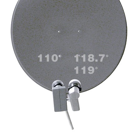

Do you have a picture of your dish or bracket?
Username: Canadastar
Post Number: 11
Registered: Oct-09
I don't have one handy, but I can take one. It is almost same as picture put out by Whiskey on htis thead.

Username: Nydas
Post Number: 16425
Look at the picture above. Where it says 110 is where you will currently have a 110/119. Replace that with a 118/119. To the right where in the picture it say 118/119, is where you currently have the 121. Remove it.
The final installation picture will look like what is posted above, except it could be 110/119 and 118/119 side by side, if you do not want to buy a new LNB just for 110

OK Folks. Just to give you an update.
Before I was about to replace my old LNB, I tried to play around with SW port on dish settings with old LNB on. It turns out that, I can actually get 118.8 and 119 with my existing LNB. And It happend to be the one on center, not the one on left as it shown on the picture. Therefore I left it alone and didn't replace it. But I did pulled out my 110 LNB prior to that. Now I am getting 91 on small dish and 118.8 and 119 on big dish. I am planing to put back my original 110 LNB. I hope it will work. Thanks for all your help.
Cheers.
