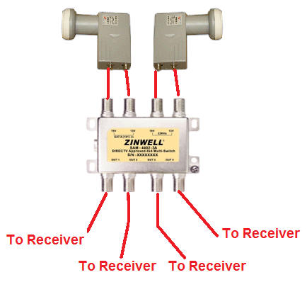

Username: Albertwhite
Registered: Oct-09
Thanks for all of your help.I heard that direct tv will also provide this type of facilities?so i want to know that what is difference between dish tv and direct tv?Do they use different technologies for signal?
Username: Watch_dog
Post Number: 59
Registered: Apr-09
albertwhite
NO only System encryption
DirecTV uses Videoguard
Dish Network Nagravision 3
