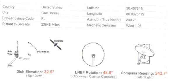

Username: Jay_w_grayson
Prague, Oklahoma
Post Number: 676
Registered: Jul-08
Adam Johnson
Your Settings for Ciel 2 at 129.0°W
from Gulf Breeze, FL.
Check these settings out
