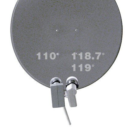

You need a 30-33" Dish. One special LNB for 118/119. You can use the old LNB just for 110. You are better off with a separate two output LNB for 110 and then process the signals through two DisEqC switches, because your new 118.119 already comes with two identical outputs.

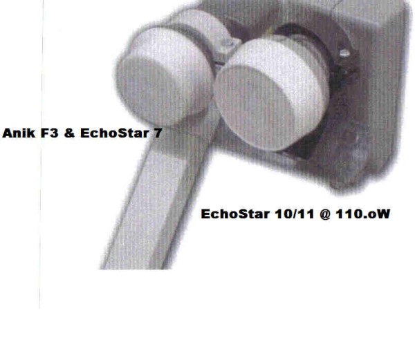

MECHANICAL CONSIDERATIONS: I have only this for Superdish.
CB2008A cannot directly replace the 119 LNB on the Superdish. Superdish lnb for 119 has a special bracket. If you are good mechanically ,you could probably figure a way to mount it on the Superdish; - it is not impossible. Iit requires a rectangular mount similar to those of DTV. The mount for Dish LNB have one side that is semicircular.
Switching You will have to get two cables for two receivers. One cable cannot be split inside the house for two receivers.
The following gives mounting on a generic Dish - IT WORKS. I think Transat sell Digiwave DGL1189.
http://transatelectronics.com/store/33inch-dish-for-110-1187-and-119w_P321
With your 500 Dish you will have to figure out the brackets. I would still discourage you and suggest NOT to waste time with 500 Dish. 30-33" dish is the way to go. 500+ or 1000+ is what Dish recommends.

@Africanbrit do you think I can mount these two separate LNBs (110 & 118/119) on my current dish-500? I am not sure of brackets and all.. what kind of brackets will I need to mount these on dish-500?
If I can mount these, then your solution looks very good.

with your existing dish you will not need and brackets
you will remove the lnb from the yolk ( which is the bracket) that is already there and put the new lnb's there

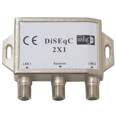

Also, do you know if I can combine these two LNBs using a sw-21 switch or a DisEqC switch?

1. DP34 does not work with CB2008A. I do not know if it works with Digiwave DGL1189. This info is related to the special LNB for 118/119. There are non-DN, 3 input 4 output switches available.
2. If you are buying a DiseqC switch, 2 to 1 and 4 to 1 switches are about the same price, so i suggest you buy 4 to1 disEqC if you need a swtich of that type.
3. If you are only going to use one receiver at a time, you can loop out from back of receiver.
