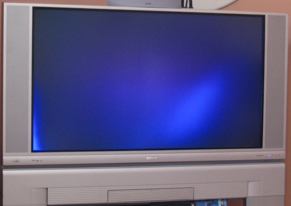

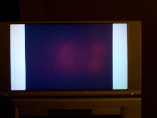

Username: Danshan
Our blue blob (right top hand corner) and red cloud (large in the centre of the screen) journey has begun.
Thank-you to all who have posted as undoubtedly, we would also be paying for the light engine.
Sebastien was the call taker this morning after calling 1-800-hitachi. He was professional, not overly friendly but obviously well-scripted. He refers to no recalls at this time, etc etc. He would not commit to any diagnosis claiming one cannot be made over the phone.
My only concern is that he advised that the tv (50v500) is only warrantied for 12 months and that the 3 years being referred to is the extended warranty. I advised him he was mistaken. He advised that each case is examined by Hitachi head office on a case by case basis ... obviously protecting themselves from a class-action civil litigation due to this obvious systemic defect.
Oh well ... off to the authorized repair place I go and of course, having to pay for the visit from the service centre to 'diagnose' the problem, etc etc.

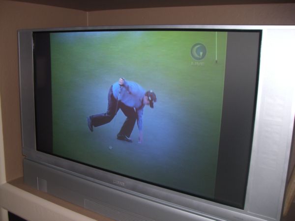

First pic shows the nice red cloud.
Second pic can't even make out the 08 because of the cloud...this was from an HD cable feed.

I recently replaced the light engine in my Hitachi 50V500A, no thanks to Hitachi, and it worked fine for about 4 weeks. Now it is doing some strange colors following contours and edges. I have attached pictures of what it is doing and would appreciate any help.Upload

Chas, thanks for the info. I did the memory init and it did help, for about 10 minutes. Then the funky colors came back. Could this be a cable connection to the light engine, since I did replace it recently?
Everette
Username: Everette
Registered: Oct-08
The problem has progressed to where the color is mostly chartreuse over most of the picture. Does this sound like a light engine?Upload

Everette,
That really looks more like a bad connection somewhere. It's a 3-color engine, so once you lose Red & Blue you're left with shades of green. I know it's a lot of work to find & re-seat all the connectors, but I think you need to try that.

We have a 50VX500. We have blue around the edges of the screen, like a blue picture frame more prominent on dark images. What button do I have to press to see the 480I, 480p, 1080I and so on displayed on the tv? In the service menu it shows 19411 total. It cant be hours cuz I can see it change several times. I saw a lamp time reset but no lamp time values.

Hitachi replaced the LE and we covered labor ($200). I cant complain as the set is 3 years out of warranty. This was a floor model hence the 19,000+ hours. The service tech couldnt believe it when he saw the hours. After the LE was replaced it looked like a new tv. Brighter picture no blue frame around the edges. The only complaint is the tech did something and now the picture seems to be moved up. I can see a line of white light in the bottom right corner and when the picture has the black bars on top and bottom it isnt centered, less on top and more on bottom. Anyone know what verticle setting in the service menu to fix this?
