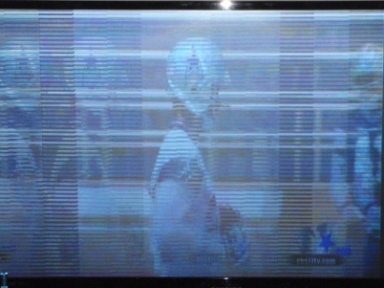

Around 8:30 last night my television went out. I can't even see the television menu becasue it is distorted. I've unplugged the power. I even unplugged everything but the power. Any help would be appreciated.

Is most probably a DMD board issue, you can learn how it works: http://electronics.howstuffworks.com/dlp1.htm basically your image shows a pattern where a lot of sections of micromirros are on the OFF position, reflecting the light away from the screen. you can get it directly from samsungparts.com http://www.samsungparts.com/part_detail.asp?catalog%5Fname=Parts+and+Accessories &product%5Fid=BP96-01856A&search%5Fmodel=HLT5076S or from http://www.discount-merchant.com/We-provide-factory-original-parts-worldwide-p/1 117865-samsung.htm
