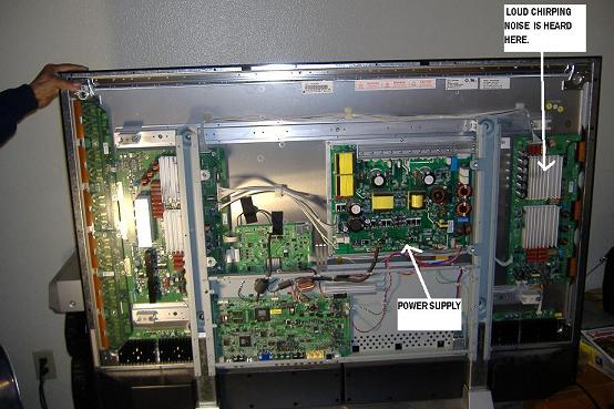

Username: Ovadoggvo
Post Number: 112
Eddie,
This is a very common problem within the Zenith, Vizio, LG, and Toshiba 50" Plasmas.. They all have the same exact PDP pannel and parts except for the digital video board..
The problem you are describing is 60% caused by a bad Y-Sustain board which can be found here for $169.00:
http://www.discount-merchant.com/PCB-Y-SUS-MAIN-FOR-HP-HP-PL5060N-TELEVISION-p/2 761-hp-hp-pl5060n.htm
The other 30% of the time the problem is the X-Sustain board..
10% of the time it is caused by a conflict in the bottom buffer boards.. If this is the problem you will burn a good Y-Sustain board if installed.
The way to check to see if your Y-Sus is the only problme is to measure the high voltage going in the x-sus and out of the x-sus while the y-sustain board is disconnected. If voltage if maintained, then the y-sus has a short.
If this is giberish to you, just replace your Y-Sustain board and see what happens.. The board should look like this:
http://parts.discount-merchant.com/modim/photos.php?itemid=1007231
Let us know how it goes..

Username: Hect7369
Post Number: 9
Got a Vizio P50 HDM,set is in shut down,led blinks from orange to green 9-10 times.Just a flash is seen on pic,when set tries to turn on.
A strong chirping is heard on board as ovadoggvo shows in post(boards) above.Is possible this board is defective.?? No print.
Anyone has the part number for this?
Any help will be appreciated!
Thanks!
I post a pic..may be can help to all who has one of these sets.Upload

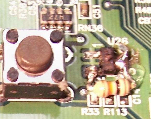

Username: Earthbonz
Registered: May-08
All,
Check this out:
kNOBLE
VIZIO
L32
LCD
DEAD WITH AN AMBER LIGHT
Do Not Order A New Board For This Vizio Model. You Can Fix This Problem For Pennys. Problem: Will Not Power Up Amber Led Only. Hint: No Reset To Operate Micro (Brain Dead) I'Ve Seen (3) Various Fixs Below, One Uses A Diode, Other Uses A 10k Resistor, Try Either. All 3 Will Work, Diode Works Best For Me This Same Reset Ic Goes Bad On Other Visio Lcd & Plasma Tv'S. #1) You Remove Smd U26 On The Video Processing Board And (Add) Put A 10k Resistor Across Pins 2&3. U26 Is Near The The Tact Switch. #2) Remove U26 And Solder A 10k Tru 100k Resistor Across Pin 2&3. Start With A 10 K First. #3) Remove Reset Ic Near Tac Switch Replace With 1n4148 Diode (Nte519). Vizio Tech Support: (Valid - I Tried It) 1-888-849-4623 Opt 4 Technical Support: 888-849-4623 Try Extension 1669 (David). Hugo Carrera Parts Department 877-668-8462 Ext 1814 Vizio Inc. 320a Kalmus Drive Costa Mesa, Ca 92626 E-Mail:Hugo.Carrera@Vinc.Com

Username: Rcapob
Registered: May-08
All
I just followed the post from Daniel Powell, DEAD WITH AN AMBER LIGHT
and it works....!!!! saved me 200 bucks at least! I started with the the first suggestion just add a 10K resistor to U26 on legs 2 and 3.
I just wanted to say thanks, and to let everyone with a bad main board to give this fix a try.

Hi all. Daniel Powell (or maby Rcapob you mite be able to anser this)
When you said-
" #1) You Remove Smd U26 On The Video Processing Board And (Add) Put A 10k Resistor Across Pins 2&3. U26 Is Near The The Tact Switch. #2) Remove U26 And Solder A 10k Tru 100k Resistor Across Pin 2&3."
Did you mean remove it for good and solder resistor to where pins 2+3 use to be? or Replace it after you solder the resistor to it? thanks for your time and wisedom ... Dan
