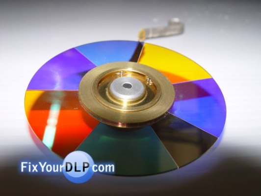

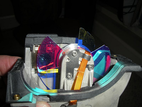

I think this could be a piece of the color wheel, sometimes they shattered sending out broken pieces. A bad color wheel makes a loud screeching, whining, or winding sound and sometimes the TV vibrates so if you have these symptoms then you may need to replace the color wheel.
This is the Color Wheel:
This is when it shatters:
