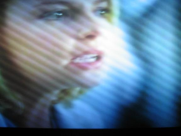

Earlier, I posed pictures of my Samsung HLP-5085W with the "rectangle boxes" of vertical lines. I surmised that this was the DMD board/light engine, although I did not receive a reply on this forum.
So, I emailed the pictures to the authorized Samsung repair center in South Florida (Lakes Electronics). They also figured it was the light engine, and sent someone to replace it.
Turns out, it was not the light engine at all, but rather a digital PCB board. The good news is that this board was $300.00, and not the $550.00 they were going to charge for the light engine.
I was impressed with the technician, as he was clearly well trained. After watching him replace the light engine, it looked like something I could do myself. But the PCB board was much more difficult, as it was buried among other connectors, boards, and steel cases. Had I attempted this without detailed instructions, I surely would have made a mess. Anyway, all is fine now, and I'm glad its back.
But I've never heard anyone else mention this board. Is this a rare occurance?

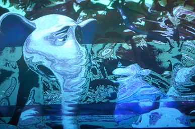

Josh Son,
DMD Board. The actual DLP chip on the DMD board is failing it seems to me from the picture. I'm not sure though. Can you describe the problem in depth? Does it happen on all inputs? did you try connecting VGA? UHF/VHF antenna?

Ken,
The Digital PCB Board you are refering to is the DMD Board. Digital Micromirrored Device is a chip that is located on the the board, hence, we call it the DMD board. It's a small chip with "millions of mirrors" on it that produce the image.
Look here:
http://www.visitech.no/bilde/luxbeam_3000_board.jpg
This is a DMD Board but not from a samsung.. I just pulled it off the net. The DMD chip is the square chip with a shiney center. The center has the "millions of mirrors" !

- HL-R5067W
- Screen image is mostly green static/horizontal lines but a faint image can be made out - cable TV source - all channels show the same static
- the PIP is crystal clear and I can change cable channels within the PIP just fine - NO cable box used
- channels numbers, TV guide menu, weak/no signal boxes are crystal clear
- DVR player and DVD player, component/source 1 and component/source 2 respectively, show the same green static as cable TV
- TV is almost 3 years old, original bulb
- I'm guessing that this is a DMD board problem even though the lamp is old since the PIP and other items are clear
- Agree or disagree?
