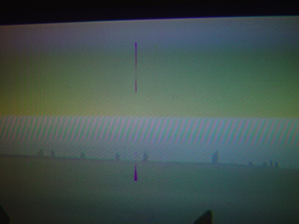

I not sure about what to next... should i go beserk vs Samsung and post picture of this tv thrown out of my window and post comments of that bad experience with them on a spe... don't know, it seems Samsung doesn't support their products and they seem to don't care about their clients!

Great forum. I have a problem with my Samsung DLP HLP5063W. The picture now shows psychedelic red splotches on the screen. It is red wierd pixcels that are especially in spots where there are dark colors. It doesn't really effect light colors. It is on all inputs. It is on the screen even on sources that have no inputs. I am the original owner.
FYI, please help. What does this sound like?

Well Katherine,
I predict Samsung will extend your warranty for 90 days and replace your board. When you mass produce electronics there will be some run errors. Most likely, everything will be fine with the new one.
D,
That's a new one!
Samsung R & D may be very interested in knowing what that is too. Call'em up and plead your case. Get past the first SR's. Be polite, but firm. Persistent is often rewarded.

Username: Raoule
Registered: Apr-07
Hello
I've got an HCN4226W with a purple streak down the middle of the screen. It's only about 1/4 of an inch wide and it doesn't vary. It actually isn't a big deal, mostly a nuisance. Still, I would like to fix it if I can. I'm attaching an image - apologies for the quality. Any help will be appreciated.Upload

Username: Geneo
First of all, let me say this is an awesome forum and I hope you can shed some light on my problem.
I have a Samsung HLR5067WAX. When I first turn it on it has a good picture but after a few minutes all the dark areas of the picture start pixilating green. This happens on both component hookups(i.e. cable box and dvd) Sometimes it will stop on its on but usually starts up again within a few minutes. It is out of warranty, any thoughts on what it could be and should I try to fix it or just buy a new TV?
