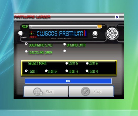

Plymouth there's a new loader out called CW600 Premium new interface.exe
http://mike.dynip.com/phcdl/file.php?id=18
May work on CW600s but not sure...use at own risk... works for me on CW600P

Doreen i use this one on picture, as you i don't knowi if it work for 600S.

Nope, the loader didn't work. I am guessing it is my cable, will try another one tomorrow.
