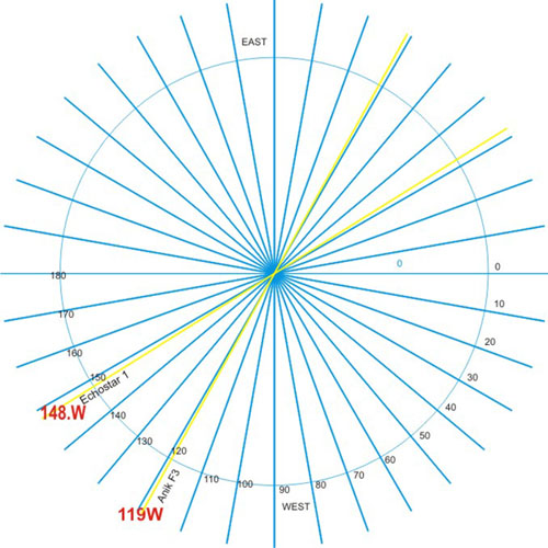

Username: Benzman
Post Number: 7
Registered: Nov-08
Hi Plymouth,
Is this Drawing pointing the right positions?
Username: Plymouth
Post Number: 6570
Benz
Use it for aligned your dish:
http://satcalculator.freehostia.com/
