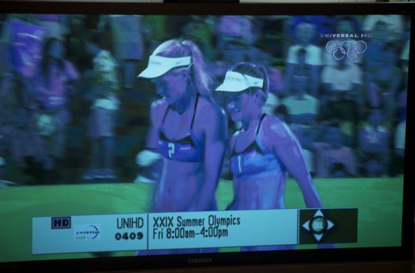

I have the same on screen display issue as David Ley on my HL-S5088W. No channel #, TV-Guide, Volume bar, etc.

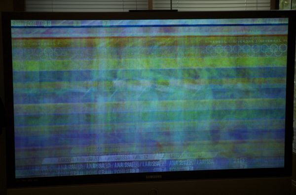

Hi. I have a Samsung HL-s5086w 50" DLP. It started with two or three little white sparklies (or better described as small white dots). I called Samsung and over the phone they suspected that it was simply dust on the lens/mirror. Well, two hours later I can assure you it is not dust. The little dots shimmer and some times change color. That does not sound like how I would expect dust to behave. I took the front off and carefully cleaned the lens and mirrors (used camera lens cleaning shammy). The picture did not change for better nor worse. I still have about 500 white dots on the screen. Obviously no warranty. Approaching 2 years old. I am baffled, please anyone have an idea?? Thanks James

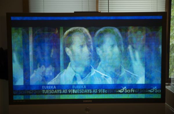

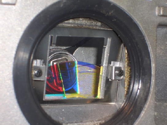

Your problem is a common one on the HLR series DLPs.. It's your light tunnel collapsing. Look:
http://www.fixyourdlp.com/wizard/distorted-picture-page-03.html
You can repair it if you have a lot of time on your hands and some beer! Be creative...I have a template made from a metal shop for these light tunnels. I use the metal to keep the 4 mirrors in place as I superglue the edges of the mirrors together... Then I pull out the metal template, and whalah!
It works.. sometimes it doesn't come out as good as new but it works great!

The problem you guys have is a software issue. The TV can not boot the complete OS for one reason or another. Try taking out the lamp, and leaving it out... Then attempt to power on the TV. It will give you blinking lights (obviously)... Then uplug the TV and plug it back in after 5 minutes with the lamp out... Re-install the lamp, and power on the TV set. At times this procedure causes the system to go into a non-normal booting procedure. When you put the lamp back in, it re-initiates itself. It has worked for me on a situation where the button set wasn't responding. It may work in your cases.
Chooka Booka... It seems like your TV set is experiencing dmd chip issues.. look above to what i recommended to Tyler.. It may solve the issue. But guys, try to use something "Eraser Like" that won't melt or cause a fire!

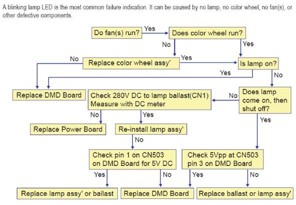

Ballast or main Power Supply is the issue.. I would try ballast first.. Look at this troubleshooting guide:
http://www.fixyourdlp.com/wizard/launch-window.html
It may help!

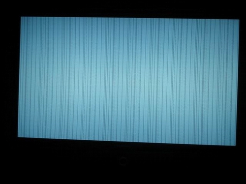

i have a samsung HLS6187WX and its making a loud rattling noise and the picture flickers i also noticed it takes a long time for the tv to power off for example i turn it off and the screen goes dark but the rattling continues i have already changed the color wheel but it did not help, the noise sounds like its coming from the lens thanks in advance.

Username: Lrpasni
Post Number: 7
Registered: Aug-08
ia2ca,
You are one step ahead of me if your color wheel is moving. Attached is a flow chart I've found for our common 46". For your situation it would recommend checking voltage to the ballast (the two wire plug going to the ballast), and go from there.
If you end up having to check pin #1 on CN503 of the DMD board, it is kind of tough but you can do it if you have steady hands and a small voltmeter probe. Good luck.
Dean,
I'm struggling with the thought of replacing components at random or just purchasing a new television......not sure what I'll do yet.

Note that the power board isn't generally that expensive - if you look around on partstore.com or samsungparts.com, you may be able to find one for around $100. That's not often the problem, though. If your color wheel is spinning and *not* making any unnatural noises, then I would look at lamp next, then ballast, then power board, then DMD.
If you have two TVs though, swapping parts should be very useful. Sometimes the sensor goes out that counts the color wheel rotations on the color wheel assembly. Happened to me. Take a look.

Based on the flowchart that Louis Lrpasni posted, it looks like the DMD board needs to be replaced, but I would love to get some other thoughts on this -

I know you probably replaced the DMD based upon the above chart. Did you test the power coming from the power board before you did that?
I had missed your first list item saying you had to unplug it/plug it in to get it to work. Has the power board been swapped out?

Yep, that part number looks correct, and I would definitely put the old DMD board back in so you can effectively narrow down the problem. Hopefully the screen at least lights back up!
The test in the chart for the power board measures the current to the ballast. Since your lamp is turning on, I'm sure that is fine, as the ballast is working properly.
Your symptoms suggest something is failing and the set goes into its standard power recycle. The issue is 'where' the failure occurs - and if the power board doesn't fix it, then you've pretty much exhausted all the parts that people will replace without just getting a new TV. I've heard of light engine failures, but know little about it except they are expensive to replace.

Scott,
I have a similar problem....lamp light blinks forever....it only turns off if I unplug it. When I plug it in, I can hear the power board click, fans are running, LED lights on the analog board are lit, lamp light on the front blinks forever, but nothing else. I'm getting power to the ballast.
Per the flow chart in a previous post, the first step was to see if my color wheel was running. You can check this by removing your bulb and while holding the blue cover switch closed, look at just the right angle to see if your color wheel is moving.
My color wheel was not moving. $100 and a new color wheel later, the new color wheel is not moving either. The flow chart will direct me to now replace the DMD board.
I'm trying to decide if it is worth spending more money on this, or just purchasing a new television (NOT a Samsung)!
Check if your color wheel is moving.

Trouble in paradise.
My television is 17 days outside of the 4 year service plan I purchased for it from Best Buy.
Attached are three images from the television when I got it to turn back on. Initially when it went with three lights I assumed it was the lamp, but now it looks like a logic board, or DMD board?
When I was able to get the TV to turn on, the side buttons and remote didn't work at all, the only method for turning off the television was to unplug it, so the tv hadn't completed booting apparently.
Is this a correct assessment of how screwed I am? I called BBY for two hours and after a couple of hang ups and 5 people they told me they couldn't even send me a bulb(I thought it was only the bulb at the time) I am guessing that if i couldn't squeeze a bulb out of them the DMD board is going to be out of the question.
Right now I am extremely disappointed in Samsung and BBY, after suggesting the DLP to people for the last 4 years, I feel like a moron as when it failed everyone who rushed to me to take my money is now walking away form me as in terms of support.

Hi,
I have a Samsung SP-50L7HX 50" rear projection tv, which has worked correctly for around 2 years. The other day, I turned the tv off as usual, and the next morning when the TV was turned on, I got sound but no picture (black screen). There are no flashing lights, and the last thing that I see is the smiley face (great!) before the screen goes black.
After reading here, I unscrewed the back cover, removed the lamp, and to my dismay discovered a crack in the small piece of glass that the lamp shines towards in the lamp enclosure (not the lamp itself, which lights up correctly). I am able to see what I think is the color wheel through this small piece of glass, and also some reflective pieces of glass (light assembly?).
Not sure where to go from here - any ideas would be greatly appreciated.
Thanks,
Burger King
Username: Burgerking
Park Royal, London
United Kingdom
Registered: Aug-08
Update on above post - I think that the crack is in the UV Filter that the lamp points towards. I have attached an image of this:-
Not sure how or why this is there.

Did anyone have any feedback on the images I had posted? Am i looking at a DMD board that has gone haywire? The TV will not turn on at all now, but when I was able to get it to turn on I was greeted by the images I had posted.

So with the flow chart above, can someone describe the symptoms a little more for me?
If my set sometimes makes the loud, grating noise and has no picture or has colors that are off, can I feel pretty solid that the color wheel is the primary problem?
When the lamp is bad, what sort of symptoms would the set display? My set (2003 or 04) has never had the lamp replaced.
I get intermittent problems with the set not turning on, usually cycling through 3 attempts followed by the 3 lights. Also, the banshee wail typically picks up during these times. At other times, the set works perfectly.
