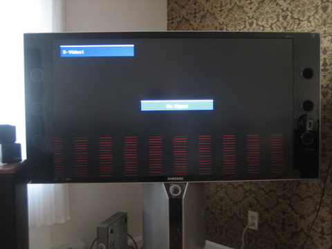

Username: Xrufisx
Update: Tv started doing this, can you see the double image appearing.
.Upload

My Samsung 5085w 50" DLP TV seems to be having problems again. Last time the unit would not even power up,and it turned out to be a faulty cable in the base. A $200 fix which samsung did not cover, then factory bulb exploded in the unit luckily not causing any damage.
Now this time I have 10 rows of 16 high horizontal bars at the bottom half of my screen. The bars are thin and the spacing between the bars is perhaps 1/2 to 1 inches apart. Any one have any experience with this? Also the lines are always there, in any tv mode my cable box settings, my dvd player etc. The only time the lines disappear is when I go into the Dnie settings adjustment. Heres a picture attached for reference Thanks in advance

Username: Ovadoggvo
Post Number: 152
Shoot guys! I haven't had time to help anyone for the last 3 weeks and look! Like 50 new posts!!!
I'll try to catch up sooner or later. Just keep tight.
SITO,
Call Discount-Merchant.com and ask to speak with "Ali".. Tell him someone on the forums sent you. They have the light engines for your TV brand new. How do I know? They offered it to our company and we rejected the purchase. They are brand new light engines for the CLEOPATRA Samsungs with a new lamp. I don't know how much they will sell them to you form but i'm sure it will be a fair price! Otherwise Samsung wants over $1k. I don't think DM will ask you for more than $400-$500. Make sure you mention the fact that it's a CLEOPATRA model Samsung. It's worth a shot!
DAVID LEY,
Try a factory reset. Turn off the TV.. Press Mute, 1, 8, 2, Power on your remote.. scroll down to factory reset. See if it helps. Also.. try unplugging your TV for 5-10 minutes then turning it on with the service menu (mentioned above). Good Luck!
Username: Ovadoggvo
Post Number: 153
Babu Sundaram,
The problem you are describing is a failing Digital Mirror Device Board (DMD).
Ryan McMahon,
The problem you seem to be having is most likely a DMD board as well. Unfortunate!

I have a samsung 61" dlp screen that is almost completely shaded, but for a 6" to 8" strip running vertically along the right edge.
The shaded portion is viewable but not enjoyable.
Could someone please outline a troubleshooting plan for me. I think I can fix this, but two heads r better than one. Thank you.
Username: Robssamsung
Registered: May-08
Oh! BTW, my model # is HLR6178WX.
Thanks again.
