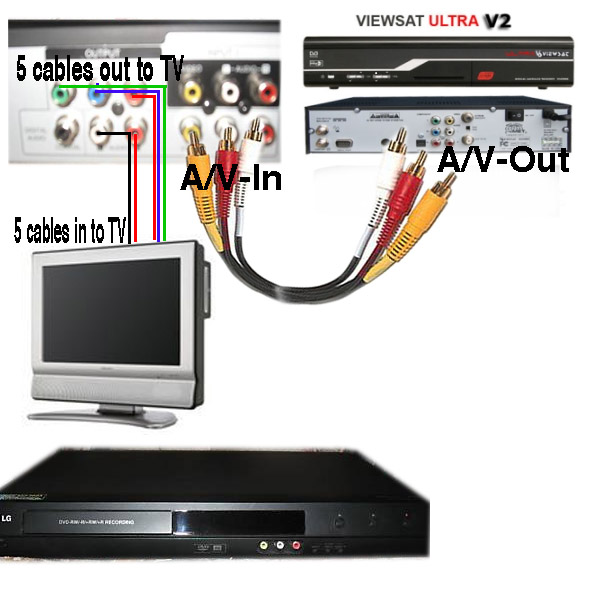

Follow my diagram:
This recorder is a progressive scan output
i.e.
5 Cables (component out) must be connected from receorder to TV
