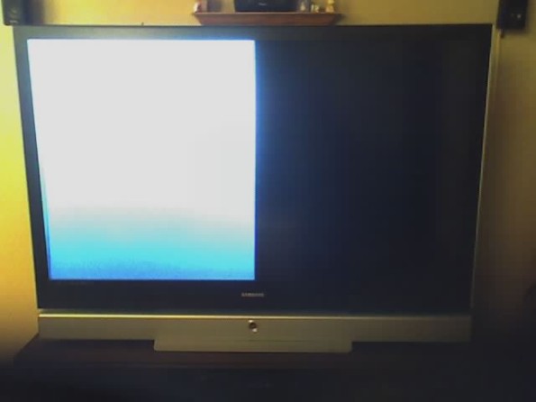

I have a Samsung HLR6768WX/XAA and here is a picture of the screen. Samsung website says it's the DLP Light Engine and Tekniton says it's a bad DMD board.
What do you guys think?

I think it's broken.
Does it display anything when you send it content?
If it's the DMD board would there be light at all? The engine controls the position of the dlp mirrors, so it makes sense that is what's broken. At least to my mind. I have an early Samsung DLP and the tech came to my house to fix the voice synch issue. When he buttoned it up at first it did this. He had to reset the cable to the light engine to get it lit. Humm, perhaps I am arguing for the DMD board then.

Now it doesn't diplay anthing when it's recieving content - only the pure white and black half screen shown.
Before it failed completely, it would display half the screen normally with the other half black. Sometimes I could get it to display a full screen of normal content by powering down and up again.
This kind of behavior also leads me to favor the bad DMD board hypothesis.

Now it doesn't display anything when it's receiving content - only the pure white and black half screen shown.
