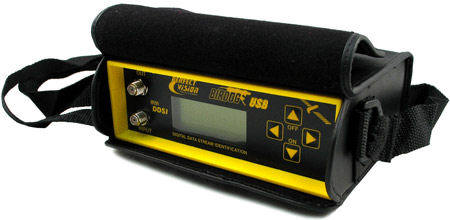

Do you know what's the most accurate compass we can find?
Get the Bird Dog, he can find every Bird in Clarke's Belt.
