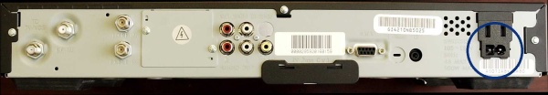

I have the Motorola SFT 2 cable box, and my tv is a 1987 RCA Colortrak, Model FPR520WR.
(Ignore the circle on the back of this. These are images I found, but it shows what I have.)
Thank you again to all who have and may be able to help with this. I'm debating too, if it would just be wiser to get a new tv. I had no idea mine was so old till I looked at the back of it.

I can't tell from those images whether the red/white/yellow connectors are inputs or outputs.
If they are labeled as outputs then you can buy one of these that David Massey wrote about. $10

Those are outputs. You really should get a new TV if you can afford one. DVD recorders output around 500-525 lines of resolution. THe best that can be done through RF is 330 max with the quality varing greatly depending on the RF input of the TV.
