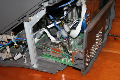

Username: Ovadoggvo
Post Number: 17
Alan,
I've seen this issue before and the service center is right. The problem IS normally the Digital Board. We normally see that problem sourcing from the HDMI port being shorted out. It leads to an open circuit on the D-Board wich takes out a cluster of the inputs.
The reason half of the ports work and the other half don't is because the inputs are separated by clusters. You should check to see if your DVI and PC IN ports are still functional.
The D-Board is not too difficult to change if you can remember where all he cables and screws go.
Here is a good picture of what you should expect inside your set:
Username: Jcmnyu
Ovadoggvo,
Thanks for the information.
I don't have anything that uses DVI, and it's funny you mention it, but I don't think my PC IN port ever worked. I remember trying when I first got the TV and not being able to get it to work from my laptop. It wasn't important enough for me to get it fixed as I never really planned on using it, I was just testing out of curiosity. Hopefully the board was the problem for that too.
My worry, and I don't know if it can be eliminated before hand, is that the new PS3 caused the issue. Is it possible the board was shorted out over the HDMI cable? Or is that sort of issue caused other ways?

Does anyone know what the ASSY CODE is compared to the PCB CODE in a Samsung service manual?
I figured out that the board that is blown in my HL-P5685W is the analog board which amongst many other things supplies power to the cooling fan (and I can see that the part labeled BD151 is fried and its supplies the 12V power). The board in my TV has a label of BP41-00122A but that is no longer available from Samsung parts. The service manual lists two part numbers though. One is called the ASSY CODE and its BP94-02140B and that is available (and the other is the PCB CODE which matches the BP41-00122A I see on the board itself).
So can I order the BP94-02140B item and is it the same thing? The two different numbers are confusing me and I don't want to spend $200 just to find out its the wrong part!
