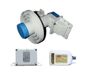

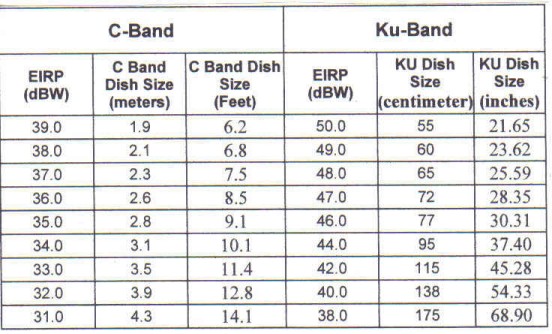

The size of Dish depends on your location
and the satellite you want.
With this LNB you can pickup both.
........C/Ku Chart.................
Username: Tasmanian_satellite
Post Number: 57
great info and thanks for the photos..really appreciate it..
