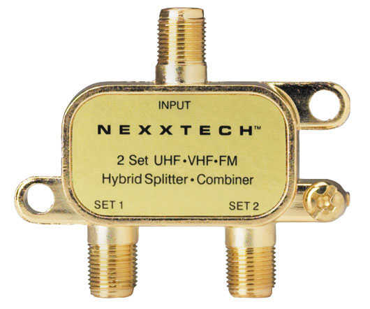

He says on his first line is a switch and was working fine for a week it was plain english language T.F.R. that hybrid sw in photo is a multi purpose splitter/combiner mainly to use to combine/split cable service with satellite signal.

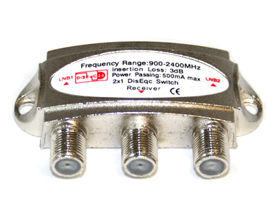

Anytime yo make changes in coax cables while receiver on can cause voltage/current spikes and possibly can damage skinny coil inside DISEqC switch best advice always turn off receiver before changing cables a simple unplug of cable in back of receiver easily damage one-input or more of that Switch
time to buy another $5 or $6 off e-bay
