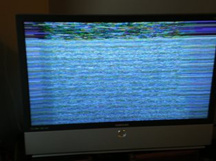

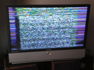

}I have read most of the posts on these message boards and have not seen a picture problem like I'm experiencing with my Samsung DLP. The lamp,2 fans and color-wheel are good. It's no longer under warrenty.When the set is first turned on the screen is white with 8 vertical columns with grey tone horizontal lines, after set warms up the colors change to blue-grn-blk.Then it changes to the posted pictures (no way to tell if they uploaded?). Is it time to dump this TV for a new one or could the "fix" whatever it is, be cost effective?

Here are the pictures refered to in my previous post of March 11th.

Ouch Cheryl! Turn it off!! It's hurting my eyes..
The problem is your DMD board. However, it seems like it may be a cold solder issue as the lines are not consistent, yet they seem to be intermittent.
You may be able to have a technician pull the dmd board and "rework" the solder.. see if it helps.
Other than that, i'm trying to find somewhere where they sell DMD boards at a reasonable price. I will post it here for everyone to see when and if i find one.

ovadoggvo-
Thanks for the reply and posssible problem.
I'll do some searching on DMD boards too.

Cheryl,
Today I came across a JVC DLP with the same problem. I talked with JVC engineers by phone because I couldn't get an answer from Samsung. They explained to me that the problem causing this is a software malfunction on the DMD board. On the JVC units it is a type of "bios" chip that is removable from a 24pin socket. Replacing this memory chip is supposed to fix the problem with the JVC set. Apparently they use a new bios when JVC refurbishes the units in their mexico facility..
I will look further into the Samsung DMDs when I have a chance to see if there is a fix for them. If not, your best bet may be a used dmd board for the time being.
