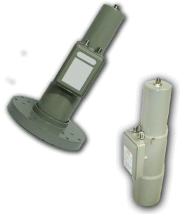

King what dish size is the best for C band and what LNB
Username: Tapeman
New York City in-HD, NY
Post Number: 2411
at least 1.5 Meter dish and a motor for C-band
Will get yo over 600 channels not on Ku band
Yo can also get a BSC621-2 C/Ku LNBF that
can receive both C-band/Ku band as well as FSS
C Band

How cost for this system with motor you think
Username: Tapeman
Post Number: 2412
Any receiver can do Ku/C band
Yo can get many non-encrypted channels
They are not going to be the main premium channels
Yo'll get hundreds of channels from North/south America
Hundreds from Europe
I have a topic coming in less than two weeks
Will help yo great deal for C/Ku
Motor about $75
LNBF is about $80 USD
Dish under $200
Check Sadoun.com
http://sadoun.com/Sat/Order/Dishes/C_Band_satellite_dish.htm
If yo have space for a 1.8 meter=180 CM
Spend total of $400
As a hobbyest priceless experience
