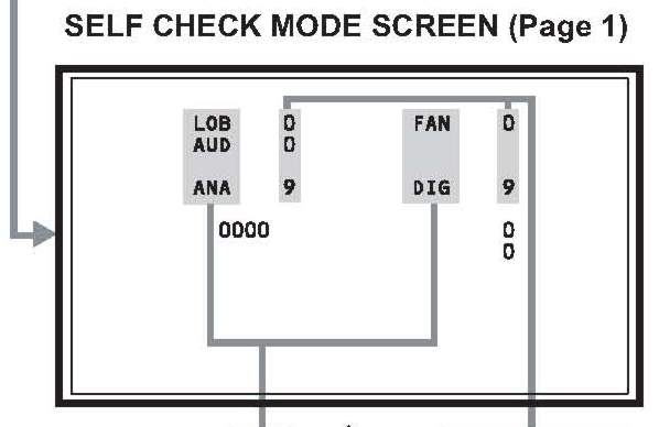

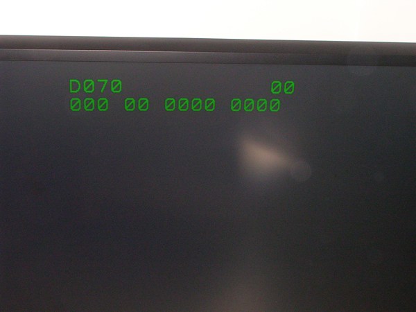

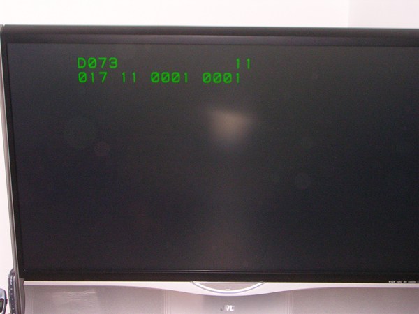

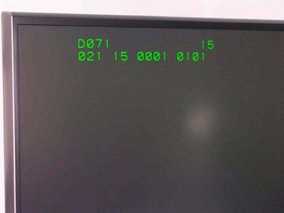

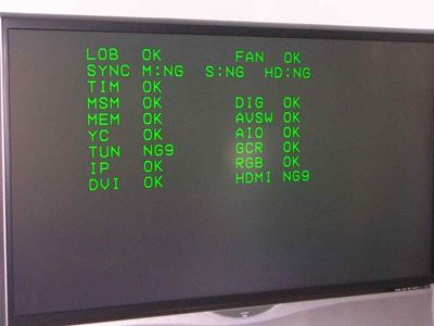

The lamp time can be checked from within the service menu; the number of hours (in hexadecimal) is listed on the status page. Obviously, to see it you first have to change the bulb. Then, after changing it, you note the hours, and then reset the timer to zero for the new bulb.
If you are only at 8 months, you are still under warranty and JVC should give you a new lamp at no cost.

Be careful, because you can screw up the set in the service menu.
Also, actually, with some searching you can find the entire service manual online (I saw it in another forum).

Username: Sicinho
Alright ... I give up ... I just can't understand this hexadecimal number.
My service menu says:
D074 6B
107 6B 0110 1011
D073 11
017 11 0001 0001
Any ideas??
Username: Potentialjvcowner
Post Number: 59
Please post the entire screen contents in the same sequence and arrangement as it appears on the screen.

Username: Sicinho
Post Number: 7
Pictures from my tv ... service menu
Post Number: 61
Those are the wrong screens. Exit the service menu, then re-enter it. You should have a menu of three choices, 1 - Adjust, 2 - Self Check, 3 - I2C Stop. Select 2, and you should have a screen with 5 lines of numbers on it. What we want is the 4 character hexadecimal number on the left side of the 4th line.

Username: Sicinho
Post Number: 8
Barry,
I'm gonna take a picture of that other screen and post it later.
I got to that screen because a read something earlier on this forum saying to press #4 , then use the channel up/down button 'till get to this D074 and D073.
From JVC TV USER
...." If you reset the bulb timer with your new bulb then look at register D073 and D074 to get the hours on the previous bulb. Registers D070 and D071 have the hours on the current bulb.
Enter service menu press 4 then press sleep button to until you get to the H001 register group then use channel down ~20 times to get to D070."
Do you know anything about this??
Thanks a lot for all your help
Post Number: 65
Carlos,
If the numbers in the register are to be believed, then the previous lamp life was 116B [hex] hours, which is 4,459 hours. I'm not sure that your information is correct. It would have helped too if you'd have include regester D071. I'm not sure I buy this, first of all, this is supposedly the life of the PREVIOUS lamp, not the current lamp. But aren't you, in fact, on the first lamp?

Username: Sicinho
Post Number: 9
Hey Barry,
here I am again ... I'm sending the 2 pictures. First that screen that you first told me about. I also took a picture of that register D071.
I already replaced my lamp. My Tv was too dark and I couldn't see anything on the screen. So I ordered one online. I completely forgot about the warranty, actually I didn't know that JVC gives one year warranty for the lamp also. I contacted them today (thanks to you) and I just fax my receipt with serial number. Let's see ... maybe I'll get a spare one
4,459 hours of use !!!! That's a lot !!! I owned this set for only 8 months.
Post Number: 67
NEITHER ONE OF THOSE IS THE CORRECT SCREEN.
I'm not at all sure that the number that I gave you is correct, but I don't understand why you are having so much trouble getting the correct screen. It should look like this:
The 0000 below ANA 9 is the lamp hours (in hex).

Barry,
I got that first screen doing what you told me to do before....
when I selected #2 (self-check) I got that screen with all that information ... I didn't press anything else.
My tv model is HD52G886.
Post Number: 68
I think you have a different model than I have or than my manual is for. My unit is a 56FN97; there are also "FH" models. Yours is a "G", and it seems significantly different (although all JVC sets use the same lamps).
As to the lamp hours, without a service manual for YOUR model, I don't think we know the lamp hours. I'd forget the number that I gave you earlier ... 116B hex is 4,459 (decimal), but I'm not sure that 116B is the correct number of hours.
I'd find a correct service manual for your specific model; you might find it online with a search, or you might buy it on E-Bay (probably under $10).

Username: Whathappend
Post Number: 7
Barry and Carlos,
The bulb hours are not on the Self check screen for the G series JVC the service manual says use D70 and D71. The 73 and 74 registers are not documented in the JVC service manual but from my TV the appear to be the number of hours the TV has been on until you reset the bulb timer. After buld timer is reset the current bulb hours from 70 and 71 are in 73 and 74. I don't know what happens after you replace the buld a third time.
So total tv hours should be available by adding 70,71 + 73,74. If you have not reset the bulb timer then 70,71 should always be >= 73,74. This is due to the fact that the 73,74 values are not updated with each power cycle like the 70,71 values.
Carlos you should post the value of the D70 register.
