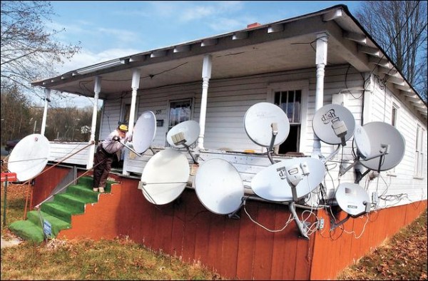

lolol
You can get all the Birds in the Arch with this setup.

Yukon this is you on photo
Username: Madflea168
Post Number: 159
sweet, where did you find that pic.
