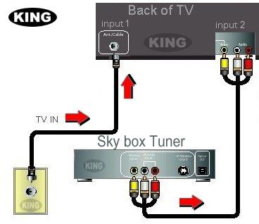

Michael based on the information yo provided and based on PIP requirments:
- PIP must have 2 tuners
- Yo can use coax cable directly to TV as tuner#1
- But since yo need a second tuner I don't know if sky box has RCA out (Yellow/Red/White)
If it does then that will be your second input tuner#2
Let me know if this works for yo:
Good luck

Yo can use S-video instead of yellow
Keep in mind
S-Video is just video plus (red and white for audio)
Audio can also be fiber optic (1-wire L/R) if no RCA
In any case
PIP requires 2 tuners
OTA Antenna or basic cable out of the wall can go straight to TV this will be one of 2 tuners the second is the additional box
Yo can also use VCR or DVR as a second tuner if yo got one
