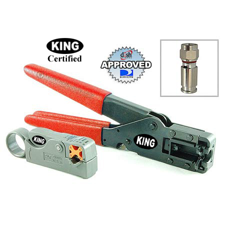

I have seen bad cables made by professional installers simply shorting shield or inadequate shield or bad crimps
I only recommend snap and seal crimps with RG-6 (double or quad shield)
There is a learning curve in how to make your own cables but not hard by any means
Correct tools is a must see picture
(Stripper, Crimper and criimp connectors)
