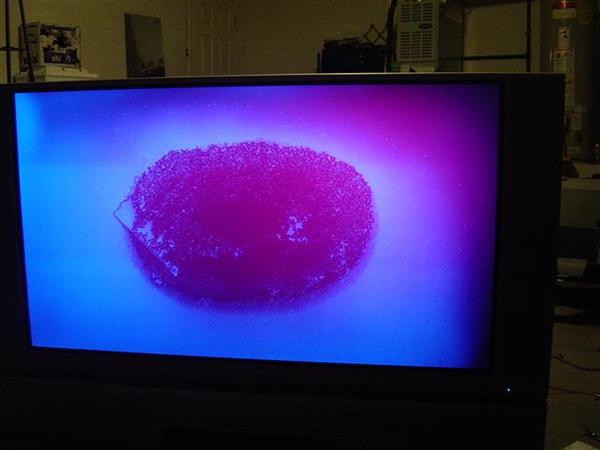

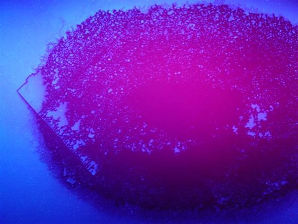

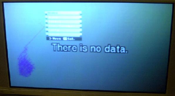

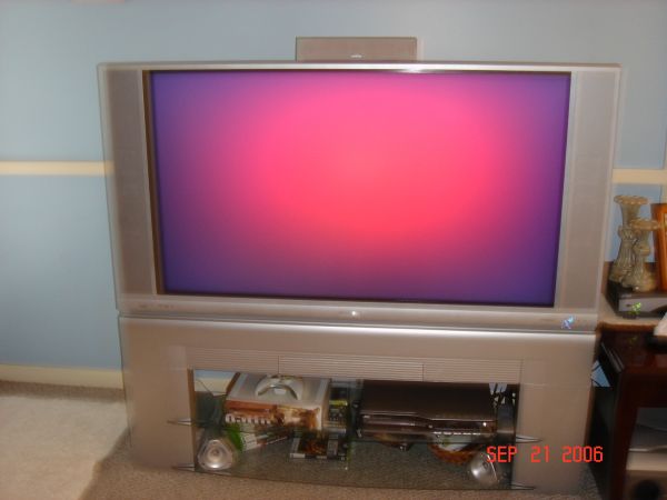

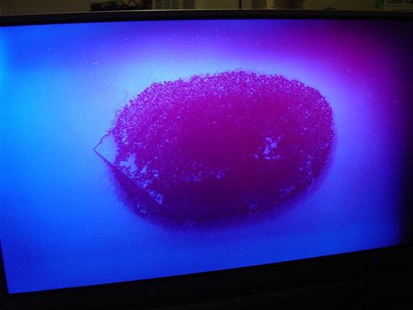

Well it seems i have found my way here as many other Hitachi 50v500 owners have, a neighbor was going to throw out their Hitachi so me being the fix it type, I decided to grab it.
I plugged it in a immediately noticed "the blob" but mine seems to be a little different than the ones I have seen pictured on the forums.
It also has no other colors being displayed but blue, and tons of dead pixels.
Just wondering if you guys think this is just an extreme case of a bad LE, or if has other problems as well. And a big thanks to all the posters in this thread, it has already saved me countless hours.
Username: Tv_mike
Post Number: 28
Justin,
This definitely looks like a bad LE to me. Although this is the first I've seen this on the Hitachi, this was a big complaint with the older Sony RPLCDs. They refer to it as the "Road mapping" problem.
I would get John S' opinion on this as well but it almost looks like what the red cloud issue could become if it was left alone.
You can see this on the "Sony Rear Projection TV Problems" thread. http://forum.ecoustics.com/bbs/messages/2/137540.html
I don't recall anyone fixing it without replacing the Light Engine.
Good Luck!

Michael and Justin;
Yup, this is a bad one. Looks like an Hitachi blob mutating into a Sony roadmap. To my knowledge, the Sony roadmaps almost never cover as much screen area as the Hit. red blobs. Also, I have no idea what the determined cause of the roadmaps is, but the conclusion on the blobs is overheating caused by inadequate ventilation.
Justin, you may be able to get Hitachi customer relations to cover the LE while you pay labor (about $300). If so, you have a good bargain TV. If not, this TV isn't worth the $1500 or so to repair it, imo. For another grand, you can get a far better display new these days.
I would be curious as to how many hours are on this set. You can find out by accessing the service menu. With the TV off and cold, press and hold the input button, then press the power button on the TV's front panel. I'll bet the hours in the upper right corner of service menu's first page exceeds 5000.

Username: Airhog
Florida
Thanks for the help and the links guys, glad to hear it's most likely just the LE. I'm going to give Hitachi a call (Worth a shot) If not, I'll see if i can find a rebuilt LE for around $400 and install it myself.
Am i correct in assuming the "D" designation in the part number for the LE is the revised model with the vent moved? I've read all the posts but my head is spinning from the sometimes conflicting info.
As for the hours, it was one of the first things i checked after downloading the service manual to see how the bulb is, and discovered whopping 7640 hours on the set. Unfortunately i don't know what bulb number this is, so i have no idea of knowing when it will go.

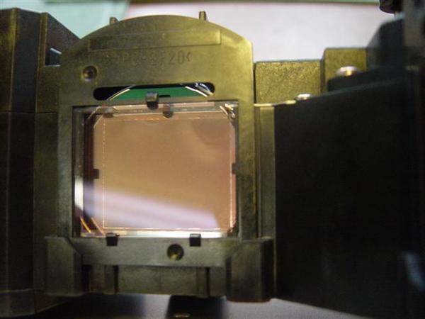

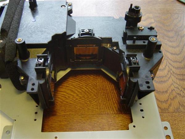

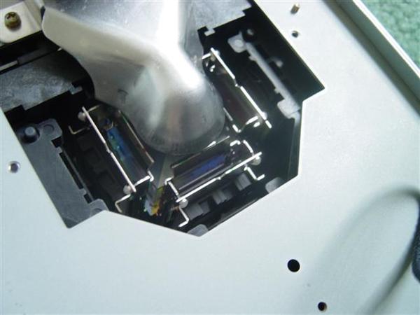

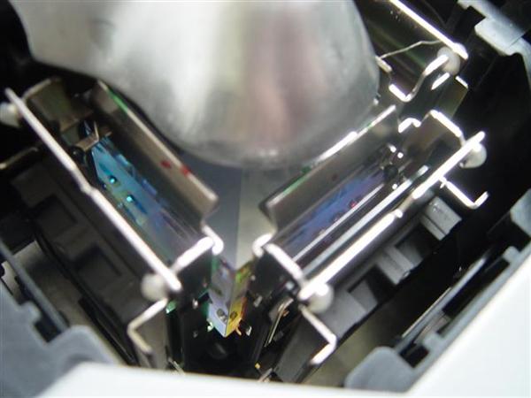

Alright, so if you read my posts above you saw the extreme case of the blob i was experiencing when i rescued this 50v from the trash.
I contacted Hitachi, and after a bit of talking they were pretty quick to offer me a new part for free, so no problems there. they even shipped it 2nd day air (kudos Hitachi:-))
Any way, long story short it will be here tomorrow and I'll be installing it myself, and take detailed pics for all of us here. Its not that difficult. I pulled the old one out in about a half an hour.

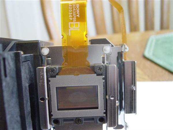

So on with the show... First thing i wanted to do is find out exactly what is failing and why, we are all pretty aware that the ventilation on these TVs is not adequate, so lets take a look...

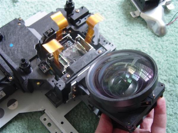

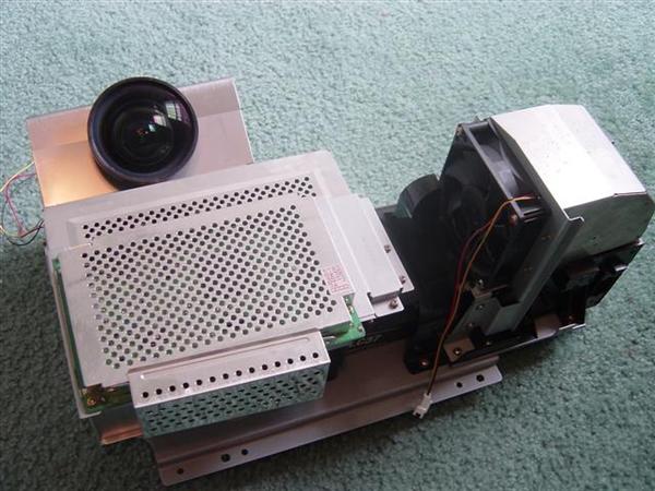

Here is the entire optical engine or light engine assembly, this one is part# ux22201 (OEM original) The two vented boxes on the top are the LC3X drive board and the FC4 LCD board, to the right of those you can see the fan and duct system for the light bulb, above the PWB's you can see the lens that projects the picture to the screen.

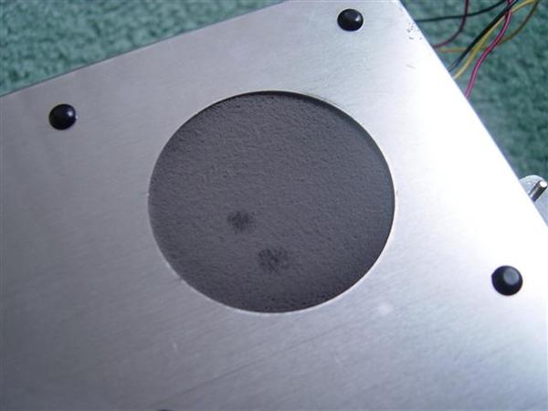

Flipping the entire optical engine over, under the PWB's you can see the intake port for the cooling fan that cools this beast down.(notice the dust) The problem with this is that there is only about an inch of clearance between it and the bottom of the set.
Here you can see how much dust has accumulated inside the filter, I shifted it over slightly to show a clean portion of the filter. Sunlight doesn't even penetrate through it. When this was running there was almost no air flowing at all. On a side note if you are not experiencing the blob plague yet, cleaning this periodically will practically solve your problems... well some of them any way.

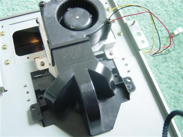

Underneath the intake cover, you can see the ducted fan that cools down the LCD panels and the other optics.

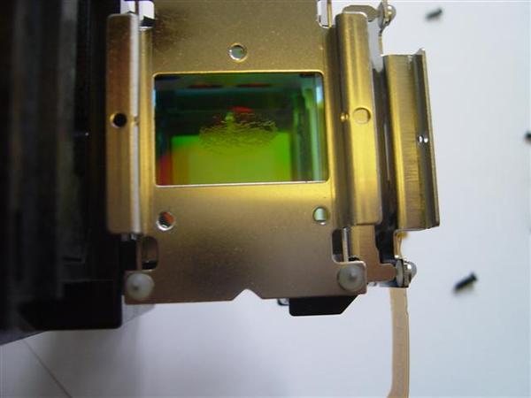

Underneath the ducts, you can see the heart of the beast and the affected components.
Flipping the unit over and removing the drive boards, this should give you a better road map for the layout. The three ribbon cables are attached to there respective red, blue, and green LCD's these in turn attach to the LC3X drive board.

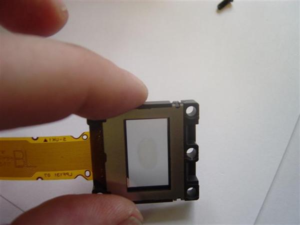

On to heart surgery, here with the assembly removed, you can now see the LCD screens. You can also see why another big name manufacturer is having similar problems with there light engines... Yep that's right the Lcds are made by Sony.

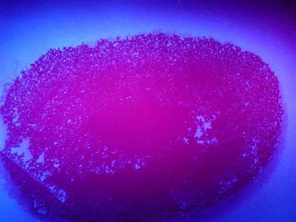

After completely removing the LCD you can see the "blob" in all its glory, yep thats it, less than an inch big in the center of the LCD there. If you are having minor Blob issues, this is your culprit. The extreme heat from poor ventilation is frying the LCD.

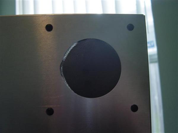

In my case of the extreme blob, the heat was so great it was destroying one of the filter lenses, it actually has physical cracks running through it which were reflacting the light to give the super blob effect.
You can see the result of the damage here

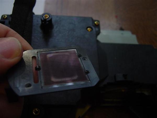

Moving on to the rest of the unit, you can see more damage caused by the heat, here is the portion of the assembly that reflects all the light from the bulb to the LCD's
More heat damaged components, this is the green lens, if you look in the top right corner you can see what appears to be some sort of fuming issue.
Another damaged filter...
So now we know whats wrong and why, when my new light engine arrives tomorrow, I will go into what changes were made, and see how well airflow is improved. I am also dying to know if they are still using the Sony LCD's.
After all is said and done, i would like to add some well placed fans inside the unit to help keep it cool, And then post a step by step on how to install the unit. All it takes is two Philip's screwdrivers.

LE=Light Engine.
It is the heart of any fixed pixel rear projection video display.
This diagram is from Hitachi's site:
Username: John_s
Columbus, Ohio
US
Post Number: 1135
Registered: Feb-04
Eric, please see Justin's excellent series of pictures above.
Many thanks to you Justin for the work!

Username: Tamaneko
Excellent post, Justin! Thanks for the pics as well. Out of curiosity, did you use some sort of guide in taking the optical engine apart?
