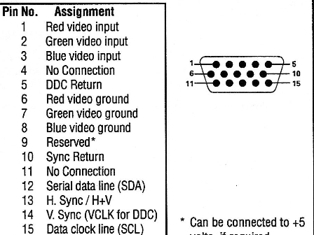

Craig, as you may have already found out, RGB --- while considered a form of component video --- is not the same as YPbPr or what is normally referred to as "component" video. The key connector pins on 15 pin VGA (aka HighDensity 15) are as you point out are #1, 2 and 3 for red/green/blue. But just as important are pins 13 and 14, for horizontal and vertical synch respectively. On the other hand, what is normally referred to as "component" video is YPbPr, where Y = synch(v&h) on luma (b&w) + green, Pb = blue, and Pr = red. The point is that VGA and 3-pin component are different and not compatible with each other. The only reason this component®HD15 breakout adaptor exists is for situations where the display's HD15 input supports 3-pin component signals. The quote from the website answers your question: Component Video is Y-Pr-Pb encoded video which is different than non-encoded RGB and RGB/HV. The Device to which the "VGA" connector is connected, needs to support Component video (Y-Pr-Pb) for this type of cable to work. In other words, the Philips monitor in question must have a "component video" switch, either mechanical or electronic, for your plan to work. Even if that hurdle was crossed, you'd still be limited to 480i video from the HD cable box. |

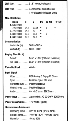

John, I have attached the specs for the display. Looks like the max rez is 800 x 600. What is this telling me? Here is a link to a transcoder I found: http://www.x2vga.com/product |

720p is short for 1260 x 720 (progressive scan) and 1080i is short for 1920 x 1080 (interlace scan). As you can see, none of these figures are close to any of the resolutions cited on your spec list. So seeing HiDef video on this monitor is out of the question. (Even if you could, the picture would be letterboxed on this 4:3 CRT to accomodate the 16:9 ratio of HiDef video.) That said, the question is can you get a standard video picture on this monitor. That's a little tougher to answer. A lot depends on whether the transcoder can step down the HiDef video signal coming out of the cable box to an acceptable resolution and scan rate the monitor can use. I cannot tell for certain if this Philips monitor is capable of progressive (non-interlaced) scan. All I can say is that all the circa. 2000 TVs I've seen with component inputs were not capable of progressive. I could be wrong, but until proven otherwise, we can assume this VGA equipped monitor can't deal with progressive scan signals either. The VGA transcoder you cite definitely does not support 480i. It does have something called 480i Easy View , but that is apparently for graphics display on some games on some game consoles. Bottom line here is that I don't think you can get a HiDef component output to work on this monitor, except maybe with the use of a relatively expensive video processor. I do think you could get this to work with a S-video to VGA adaptor. Again, this would yield standard definition only on this monitor. http://www.svideo.com/video2vga.html |

I see what you are saying. I did talk to the owner of the monitor. It does apparently accept progressive scan because he has been using it with his DirectTV HD box set at 480p. So, I guess it cannot show true HD programming, but "enhanced" TV or whatever they call it. |
