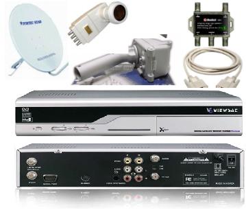

My System
Viewsat Platinum Receiver, 31" Dish Antenna, QPH-031 LNB, Motor. I currently have over 17 Satellites Scanned and over 2400 Channels some true FTA "In the Clear" and All of DN and BEV.
