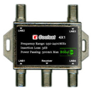

ok i had changed some stuff n i don noe waht
buh not the esho
can later someone tell me wats right n worng and wat its to be on\
satilite- echo 7 119.0w
lnb power- on
lnbtype- universal
lnb high- 11250
lnb low- 9750
tp frequency- 12224
diseqc 1.0- port 2
motor- off - dont have it
lagancy sw- none
and itt has signal but no quality
satilite-echostar 3 61.5w
lnb power- on
lnb type- standard
lnb freqency- 11250
22 khz- off
tp frequncy- 12297
diseqc 1.0- port 2
motor - off - dont have it
legancy sw- none
the siggnnal is good and quality
Username: Ke5aqn
Post Number: 3122
you have both on disqc port 2 for one thing
what port is 119 connected to?
what port is 61.5 connected to?

Usually 61.5 is connected to Port 3 or 4 and the 119 to 1 and 110 to 2.
Username: Ke5aqn
Post Number: 3125
how is this connected?

Username: Parthp18
Toronto, Ontario
Post Number: 15
k my 61.5 is on #1
and the other 119 is on #2
Username: Ke5aqn
Post Number: 3153
Cool adjust the antenna settings to represent that.

Parth,
how did you get to this section?
buh not the esho
lnb power- on
lnbtype- universal
lnb high- 11250
lnb low- 9750
tp frequency- 12224
diseqc 1.0- port 2
lagancy sw- none
lnb power- on
lnb type- standard
lnb freqency- 11250
22 khz- off
tp frequncy- 12297
diseqc 1.0- port 2
legancy sw- none
go there again,i see that you have both set on port 2.you need to change 61.5 to port 1,
try this and if you need more help then post on this same thread
Username: Parthp18
Toronto, Ontario
Post Number: 17
Afrcian it works now all becuz of u yayayaayayayya thanks man!
