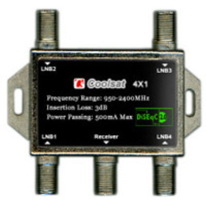

Username: Ke5aqn
Post Number: 3121
you have both on disqc port 2 for one thing
what port is 119 connected to?
what port is 61.5 connected to?
what are your lnbs? dish pro? does it say DP?
Username: Parthp18
Toronto, Ontario
Post Number: 13
i don noe waht u mean im new to this place man
Username: Ke5aqn
Post Number: 3124
the switch------it looks like this
how is it connected?
