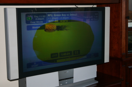

Well we had our optical block corrected today with a new light engine so no more green and yellow crap on the screen.
BUT............
Now we have PURPLE!
Oh yes! Rachel Ray was cooking with purple asparagus and purple green beans!
Sony was closed today for 'training' so the tech could not call them to see what is going on. He said this was the first time he has ever seen this and he has done 2 dozen optical block repairs so far. He said chances are it is a bad part,,,,which he has JUST replaced.
So he will call them tomorrow and get back with us.
We are so frustrated at this point I cannot even tell you!!

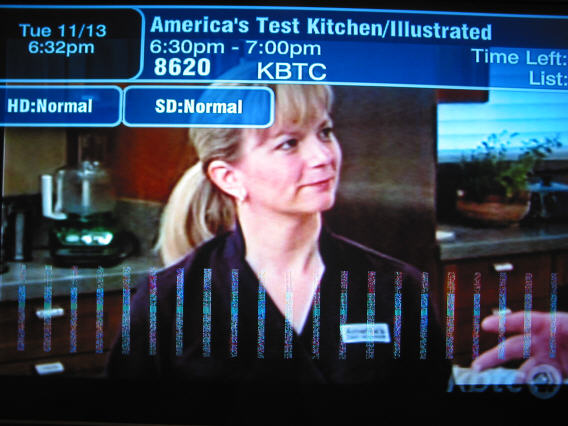

i just started having a problem with my kf50we610. it has blue vertical lines every inch or so across the entire screen. What can be the cause, the optical garbage?

Roberto, one of my failed optical block replacements, had a series of vertical lines, but they were multi-colored and were very tightly spaced such that I could really see much behind them. Your problem sounds different, but in my case, it was yet another problem with the optical block. I wouldn't be surprised, though, if this sort of problem could also arise from a bad circuit board, as well. See this post for a photo of my problem.

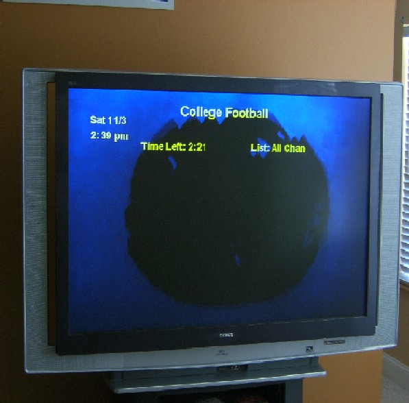

My situation being a little bit different than most..... I have ZERO PATIENCE for this kind of thing.
So... I've bought a website and a guy is building right now. Sonycrap.com.
I also have set up email for receiving any emails related to our problem. Its SonyCrapUSA@yahoo.com.
My best friend is a partner in a large law firm and is starting a Class Action suit against them with respect to these issues, Sony's knowledge of these defective issues, and their reluctance to do anything about them.
If anyone wants to be a part of this, you can email your name/contact info along with your particular model, a very brief description of the issue, a picture of a screen shot showing the problem if you can, the date or approximate date of purchase, and how you've tried to resolve the problem with Sony to my email address listed above (SonyCrapUSA@yahoo.com).
My web site will have all of this in form style to make it easier to be used as a database.
You will receive an email confirming its receipt and you will kept informed of its progress. At the appropriate date and time, I'm sure you will be contacted by the firm for more legal information. That will be out of my hands and will be through the attorneys.
Sony can blow each of us off, one at a time, but lets see how they side step hundreds or a few thousand of us in court or on 60 minutes ! ...and yes that call has been made too.

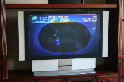

Welcome to the not so exclusive blue blob club. I've never seen anything like the picture you posted, though I have no doubt at all that you're suffering from the same blatant defect with the Optical Block that the rest of us have experienced, some of us more than once like myself. I'm guessing that the hole in the middle of the screen is just what happens when the blue blob problem progresses far enough, but it's possible that it could be something else entirely. Most people get their TV repaired before the blob completely consumes the screen because it's hardly watchable long before that happens, so we rarely get to see anything as bad as yours.

In the interim, while it is ugly, I can still watch my TV... your pic is really disturbing about how I'll eventually end up.

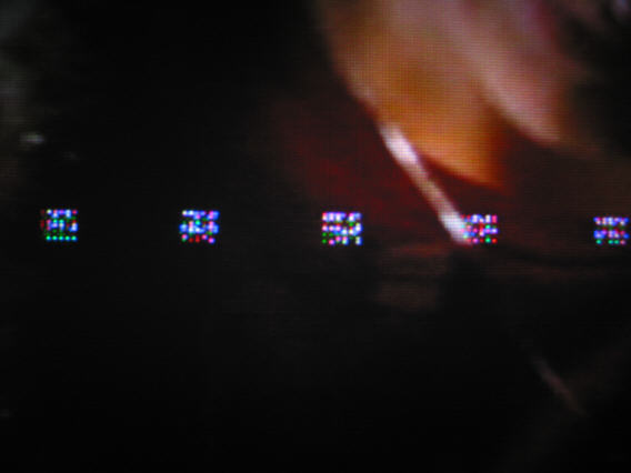

Sony KDF-E50A10 LCD rear projection TV. Anyone seen the problem (line of 28 squares 6.5 inches from bottom of screen) shown on the attached two images. Local Sony service says over $1500 to repair. Purchased set May 06.

Ron,
Although 95% of the problems on this board are related to the same thing, yours is an exception. I'm pretty sure I've seen at least one other person with the same problem post similar pictures on this board. I would suggest you just scroll back through the archives, looking at the pictures that people posted until you see one that looks like yours, shouldn't take too long since there aren't all that many pictures posted. I don't think it was in the last few months, so I'd start at least a couple months ago and go back from there 3-6 months, just scanning through the pictures.
Based on the cost of the repair it sounds like it's probably an Optical Block, but it could be a board. Unfortunately that's all the help I can give you.

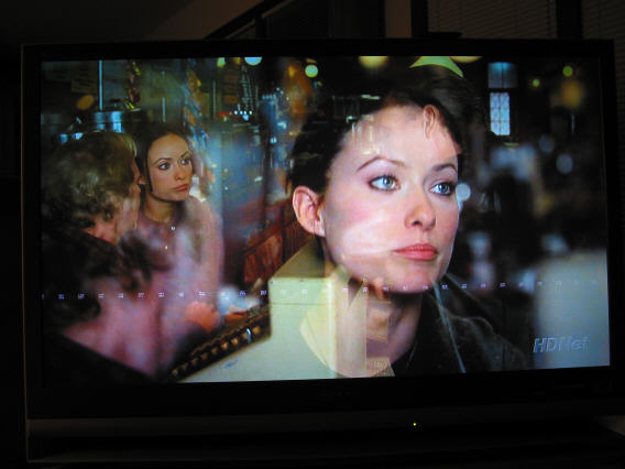

By way of introduction,I posted a couple of images recently showing a horizontal line of 28 boxes that appeared on my KDF-E50A10. I have gone the route of both phone and online exchanges with Sony "Tech Support." The hours spent in that endeavor were a waste. I have communicated with the local Sony authorized repair facility and provided to them images of the problem. The images were referred to both their on site techs and some sort of special Sony engineering support that they had access to. The result $1500-$1700 cost to repair. The problem was diagnosed from the images to be a faulty "B Box." The set was purchased from Circuit City in May 2006. After reading many of the postings on this site I felt it worth a try to try to get my case before someone in the Sony organization that might be able to give me some consideration. As a start I visited the Circuit City where I purchased the set to see if they could provide a doorway that would get me past the Sony first lines of defense. The store manager was non sympathetic and would not provide any help of any kind. Now I am asking anyone on this forum for help in determining an address/names in the Sony Co. that I could present my case to. Any ideas would be appreciated.
Username: Slinke
Post Number: 29
Ron, your TV seems to be beyond the standard 1-year warranty, but less than 2 years from purchase. As a first step, if you purchased it with a credit card, you should check to see whether the card has warranty extension coverage. For example, most, if not all, Gold and Platinum Visa and MasterCard cards double the manufacturer's warranty on purchases made with the cards. This coverage is available with some other credit cards, as well. Whenever I purchase items with warranties, including my Sony rear-projection TV, I buy them with this type of card. I figure that if electronics are going to fail, they should fail within the first 2 years, and I hate paying extra for idiotic extended warranties. Of course, in the case of these TVs, the problems seem to show up just after 2 years, so there goes that logic.
Username: Rmacc
Registered: Nov-07
Thanks very much for the reply Steve. I do appreciate it. Unfortunately I
did not purchase the set with a credit card. I purchased it using the Circuit
City 18mos no interest plan. And as per my last post Circuit City gives you
no consideration once you get it out the door unless you pony up with the
cost of an extended warranty. This evening the problem went from the 3/8" x 3/8" boxes shown in the original image post to what you see here.

heres my SONY lemon Upload

Username: Edenney
Post Number: 63
LOL, talk about a LEMON! That would be hilarious if it weren't so sad. I've never seen anything quite like that except for the picture that Rick posted of his problem on Nov. 3rd. I would speculate that both problems are related even though the colors are different and the design isn't identical. It's very likely the Optical Block, but it isn't the traditional "Blue Blob" issue that the vast majority if owners suffer from.

I am making a music video/comedy spoof of my sony lemon, I feel very fortunate to have the problem with my TV as it is like Eric said funny, I think it is the best advertisement for a sony lemon. As far as your comments I didn’t understand why owning a few other sony products has to do with anything or why you mentioned them. I guess you explained it, that it was your only connection to sony.
I only mentioned once about a possible connection between you and sony, you didn’t have to tell us again you don’t have any connections to sony I believe you.
Good for you getting your TV repaired with out the runaround most of us are getting. If I were you I would also get a lotto ticket you seem to have good fortune smiling down at you.
When sony gives you a lemon ….throw in a pineapple!
