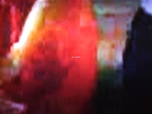

Username: Saints_fan
FYI,
I have the HLR5067WX/XAA. I have had it for 1 year exactly. For the entire time I have had the TV, there seems to be jumping light blocks dancing around in the top left hand portion of the TV. It is more noticible when on non HD stations from H10 reciever. Any suggestions? Ive called Samsung and they are sending someone out. Thanks in advance

Caden,
Direct TV non-HD is highly compressed video. This causes macro-blocking. Should be intermittent, though, and more than just the upper corner. Solid color backgrounds are where it's most noticeable. The fact that it's not consistant probably means it's not the set. How does a the internal tuner, a DVD, or other input look?

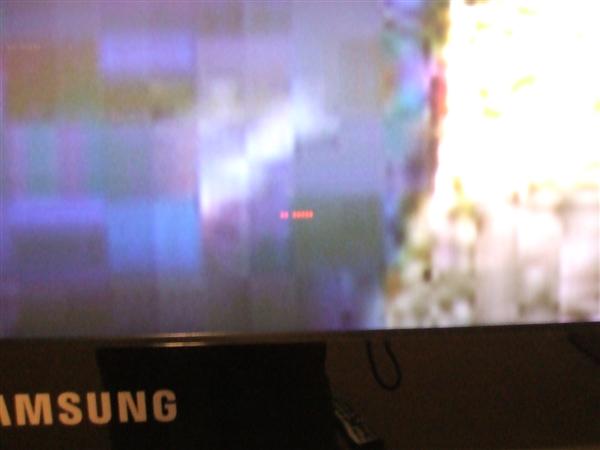

Username: Badkarma001
Dear Forum Members:
I purchased a HL-S5687W from BB on 03 Nov. It worked fine for about three weeks when the optical input failed. I discussed my options with BB crew. The gentleman who sold me the unit was very understanding and told me to bring in the problem unit and they would exchange it. I had to wait two days for a unit to come in (stock was low due to Thanksgiving Day sales...understandable). Two days later (yesterday), I exchanged units and set it up. On initial use, everything was fine. However, not eight (08) hours into the new unit, it began to fail.
Here is my question. After changing source inputs from DVD (HDMI cable with Samsung DVD unit), and to my DTV broadcast, the image quality took a turn for the worse. I have searched high and low to find a decent explaination for this problem before coming to the forum. I now see vertical lines, running from right to left at about 2-inch intervals. Each line is made of pixels from colour in the image from the left which is seen in these lines. These pixel lines are about the width of a quarter. They are not white in colour, bu rather they contain pixels from another part of the image. It is like a "shutter effect".
This problem occurs with all inputs (DTV, cable, XBox, XBox 360, & DVD). The only time I cannot see this problem is when there is a true black image on the screen. There are no "lines" then.
I searched Samsung's site for an FAQ. They have one that closely resembles the issue, but they are speaking of white lines. These are not white. They did not have an explaination for this problem.
I am going to take it back to BB and ask that the correct this problem immediately. This time, I am not going to do any of the work. As a good customer who has just purchased an expensive piece of kit, and who has had to exchange it once already, I do not feel compelled to be accomodating in any fashion this time.
As the local BB pulled the last unit out of the St. Louis warehouse, I have a feeling that it may be a while until I can get this replaced. If they cannot provide me with a satisfactory answer and generous help, then I will ask for a full refund and then buy my unit elsewhere. The guys that worked with me in AV were excellent and were very understanding and went out of their way to make things easy for me. Yet, it was a bit of a hassle to get management to sign of on this the first time. This will not be repeated.
However, I would like to know, for my own edification, what the hell is going on here. After reading up the diverse array of problems, solutions, and discussions here on the forum, I have to say that it is a good source for puzzling out problems to find solutions.
It is nice to know that there is a place, such as this, that allows a person to do a little reading and some research to acquire the requisite basics in many areas prior to proceeding.
Therefore, I would simply like to know what the forum thinks is the problem. I would like to have some semi-technical information on hand prior to going into BB tomorrow and state my case and my demands.
Finally, I work with many different complicated systems, both hardware and software. We use high-end components and bare-bones tools. Many of the projects we work on are quick and nasty builds that we know are going to fail. That is why we build them.....to see how they will fai. Other projects are very carefully built with the twin goals of durability and craftsmanship in mind. These are supposed to last forever. However, and for no known reason, they fail.
So, I completely understand when new tech comes into the market that does not completely work as intended or as advertised. That is how progress is made in future models. This is why car racing is important to your family car.
As this is my second Samsung unit in under a month, many would think that I would disavow Samsung products. Not yet. Things happen that we have no control over. So I don't become too angry up about it. What I do become angry up about is the difficutly in fixing the problem that I did not create. This, I believe, is what really needs work in the consumer electronics industry. It should be a seamless endeavor to have something under warranty and/or refund/return/exchange programme be addressed with little or no fanfare and difficulty. To date, this simply does not exist.
Sorry for the rant. The customer service system in general sucks, most of the people mean well, and I am on my second Samsung HL-S5687W in under a month.
If anybody has any idea why my eight-hour unit decided to turn into a large pinstripe montior, I would be indebted to you.
Thank you in advance for both your time and your conideration regarding this problem. I look forward to future correspondence at your earliest convenience.
BK100
Username: Fyi
Dallas, Texas
Post Number: 938
Registered: May-05
You're a rare breed, BK!
Most would come on here and slam Samsung in a heartbeat. I'd say that particular truck load had a bad ride or production had a bad run. Sounds like the digital board flaked. You're right! These are new inventions. Anything in mass production is going to have some percentage of failures. It's just a fact of life. The DLP technology is amazing, though and my research tells me it's by far, the best display technology available today. If you can just manage to get one safely into your home, it will sit there and operate flawlessly for years. A new lamp renders the display to new condition, unlike chemical displays that will discolor with age and fail completely to an un-repairable state. The Texas Instruments pdf white paper http://www.dlp.com/dlp_technology/images/dynamic/white_papers/153_Reliability_pa per.pdf on DMD chip reliability proves the chip itself can perform beyond 30 years without a single mirror failure. If only they could get the lamp, color wheel, digital board, and power supply to last that long, what a display it would be! The new LED model takes care of two of those weak links at least. It was not available when I purchased and is still too expensive for me so far. I've had my HL-S 5087W for almost a year without issue, but a few others have reported some problem with the set turning itself off. I really wish I had purchased the HL-S 5688W as I have not seen a single negative post about it in this or the AVS forums. I really don't think that one brand has any greater quality than another. Therefore, I have decided to stay with the company that has provided me with best factory customer service. Samsung is way above the rest in standing by there products. Obviously, you need to get past the first level of support if you're beyond your warranty, but they are honest and will resolve a problem for the original owner to retain a future customer. That's rare these days. Others lie to their customers and send them packing. I'll probably get a Samsung LED DLP next year when the price drops. It will be my fifth generation of DLP. I've been very pleased with the advancement of the technology and may actually keep my current model for the bedroom. Just my $.02!
FYI,
It does it on DVD too.
It is mainly in the upper left hand corner, though, where these bright jumpy blocks appear. Is this just above average pixelating? It just bothers me. I am satisfied with HD stations, but non-HD stations dont look as good as I would like.
Thanks again
Username: Fyi
Dallas, Texas
Post Number: 942
Registered: May-05
Hopefully, the tech will tell you if it's something he can fix. Sometimes, adjusting the index delay in the service mode can resolve blocky compressed video...if that's really what it is. It's occurrence in just one corner is odd. Not seeing it on HD programming leads me to believe it's SD compressed video. The tech may be able to adjust most of it out. Let us know what he says and does. Best of luck!

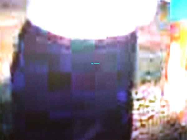

I originally posted this as it's own thread, but have now realized that Samsung has it's own fix-it thread (I apologize for being a noob).
Anyway, I have been researching a continual issue I have had with our HLP5063 and so far I have come close but haven't seen anyone with the same problems I have seen. The TV was purchased about 1.5 years ago (May 2005) and from the start it has intermitently produced colored screens. The TV will turn on normally and when the picture comes up it is entirely blue (looks like someone put blue saran wrap over the set). I was told by Samsung to go to the "My Color Control" screen and adjust - when I tried that that screen was blue too...even the menus to switch through the components are blue.
If I remember correctly, I believe it did this with a green screen and red, but blue is the one that comes up most often. I finally got the 3 blinking lights and called Samsung throwing a fit. The engine, bulb and possibly something else was replaced a few months later and the TV seemed happy, but lately it has started up with the blue screen again. Last night it did something new - it had red white and yellow lines going vertically and horizontally (almost like a big graph over the picture). Turned the TV off and waited, then I got the blue screen and after turning it off again and waiting I finally got a good picture.
So I am at a loss as to what is causing this (when I called Samsung in the beginning they didn't have any clue either). I did see something somewhere about bad connections on the component inputs and the fix was sodering the faulty component (we are using the component input for both the Comcast box and the DVD)...but I wasn't sure if this is symptomatic of that...if it is maybe it's an easier fix than we first thought. Thanks so much for the help in advance!!!!
