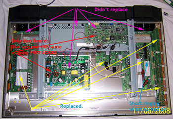

I don't know which board is the "signal" board they're talking about, or if this is the source of the problems, as I'm an ex-owner, not a tech.
But my history is I had a P50HDM which went bad, I took it apart several times and I am familiar with the component layout.
Like all flat screens, the P50 only has about five or six circuit boards (and the large plasma display) in it. Common sources of Vizio problems seem to be:
- DTV board (which contains the actual connectors the cables are plugged into)
- Power board about dead center of the TV, I'm told poor heat sinking often causes these to go bad and deliver spotty voltages to the rest of the PCBs
- Ysus board (several have told me that if this goes bad you should replace both the Ysus and Zsus boards simultaneously)
Anyway, the "signal" board sounds to me like another name for the DTV board. If it ends up you need to replace the DTV board, I have a brand new one I can sell you. I ended up returning my broken P50 to Costco, and have unused replacement boards I purchased still here in the house.

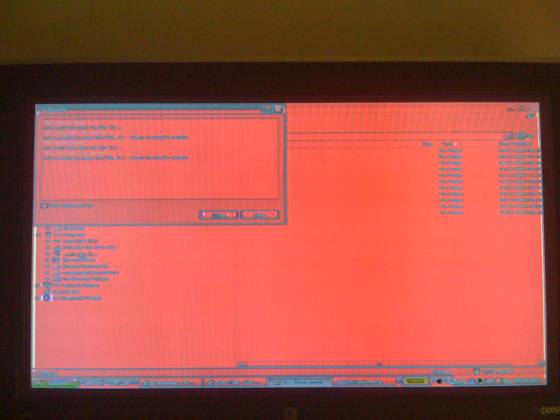

hello, i have a vizio vu42l and i use it with my htpc wich has hdmi (1080p) output and of course vga (pc) output.
i was playing clive barker's jericho on the vga output and it started raining and a lightning stroke down and i saw a yelow flash behind the tv and a soft sound like "puff" and i turned off everything right away.
i checked everything and tv tuner is working fine, vga input is fine analog input is fine , sound , but when i checked hdmi 1 where i watch my high def movies i have a blue screen that says hdmi 1 , no signal, i desconected the hdmi cable from hdmi 1 input and moved it to hdmi 2 and there i got picture.
i took apart the back cover and gave it a visual inspection all the boards in the back say lg and i did not see anything burn out , no blown capacitors, did not see any blown fuses like the one we are used to see ,i checked everything that says f1 or f2 on everyboard and i have continuity on each one so the complet and thorough visual inspection did not reveal any damage. if i saw a flash something blew up but what? where is it located?
any ideas?
i would like to have the schematic for this tv to trace whaterver you want me to trace before i get any part for it.
what can i do to solve this?
or can you tell me what could it be?

I have a Vizio 46 with a bad Y-Bulk Sustain Board V014359111401. The board has a section that is badly burned. I don't think its worth repairing so I am looking for a replacement. I know of someone who is willing to repair it but given the condition of the board I don't think that is a good idea. Does anyone know where I can buy one?

As a follow-up to my earlier post, I have some useful info for anyone that I has with a VIZIO P4 46” plasma. I got no response from my email to VIZIO tech support so I call their help line and got to speak to a live person after a long wait. When I explained my problem, he gave me the number to a parts supplier Vance Baldwin Electronics7060 W State Road 84 Plantation, FL 33317
Phone: (954) 723-9191 , toll free (800) 432-8542
The problem is that they will not deal with the general public and only sell to Certified Electronics Technicians. I did some more research and found that GATEWAY, CTX and TATUNG all sell the same TV under their own brand names. You can find the service manual by doing a search on the GATEWAY model GTW-P4m103. The amazing thing is that I actually was able to find a new Y-Bulk Sustain Board version 02 on eBay for less then $100.00 including shipping and now I am watching TV.

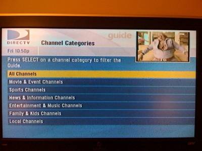

Hello,
I have a L32 HDTV unit I bought in Costco in 2006.
As of last week, I'm having trouble with the image. The color seems tinted pink-ish, with some areas that appear to be saturated, like in negative. There is also some noise and a faint flicker. This happens with all inputs (TV, AV1, AV2, AV3) and it's particularly noticeable when connecting my PC to the TV.
Dale, could this the DTV board issue? How can I be sure?
Here's a picture that might help determine the problem. The top of the image is kind of pink, and it should be white.
Thank you!

Username: Capezzani
Registered: Feb-09
I thank you for the good advice, but I'm afraid I'm living outside US at the moment. I bought the TV at Costco and took it back to my home country.
That's why I NEED to fix it, or rather throw it away.
Any help on what might be the problem? The DTV board maybe?
Here's another picture of what happens when I connect my PC. Everything terribly saturated towards pink...
Help!
Cheers,

Username: Dicepackage
Registered: Sep-09
http://homepages.wmich.edu/~s4sessio/tv.JPG
If you go to that link I added a picture of the inside of my TV (P50HDTV20A) if that helps.
On my TV I have replaced the buffer boards but not the Y-Main board. That did not fix the problem and I have probably only ten minutes on the new buffer boards. My question is do I need to replace the buffer boards when I replace the Y-Main board?
Registered: Sep-09
http://homepages.wmich.edu/~s4sessio/Picture.jpg
I replaced the Y-Main board and this is my picture. What you are seeing in the bottom right is burn-in. There is a line in the middle of the picture however. Below the line has a lot of static and artifacts and the top portion has the same problem but it isn't as bad.
