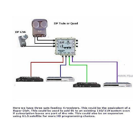

nike if you was using a disqc with a dishpro and it was working you was lucky.....
a dp34 is what you use to add another lnb to the dishpro lnb.
this pic is how it works even with one receiver like yours..

yah its work ok i try the other way that u showing in the pic i try the one .
