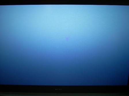

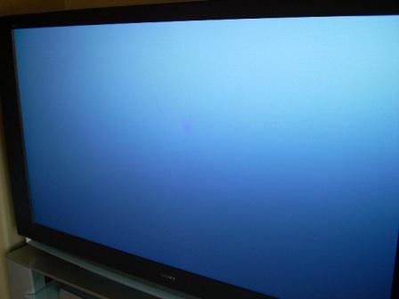

Thanks for the quick post Eric/Joey. Sorry, I wasn't specific enough to my problem earlier. I started seeing the pink stain around two months ago. I thought it was temporary problem, but just like everybody else, the pink stain has been part of my screen now whenever we watch TV. Sony folks pretty much told me that there's nothing else they could do but to recommend to replace the LCD, which would probably cost me a lot of $$.
I don't remember seeing a warranty card that says two years or so but the typical one year. Since you guys are more knowledgeable than me, then I would take your suggestion and send Sony a nice letter(Thanks Joey).
I've attached 2 pics, so please let me know if I really have a case on a possible optical block problem. I took it earlier this morning on a white screen background.
Thanks guys!

Your pictures certainly don't reflect something that was the result of having your speakers too close to the TV, even IF they could affect rear projection TVs which I don't think they would, at least not like they affect tube TVs.
Your pictures could very well be the result of the blue or pink blob problem, but if so it's at a very advanced stage. it's hard to really tell from these pictures, it doesn't look quite like the typical blob pictures most people post, but that doesn't mean much. Please describe how the problem started and how it progressed, and over what period of time.
Most commonly, the problem starts with a slight discoloration at the very bottom of the TV, usually toward the corner, and slowly progresses along the bottom of the TV until it reaches the opposite end. From there it starts growing upward and outward, and may start to come from a new point of origin on the screen as well. Eventually, the entire picture will be covered although usually some areas are more deeply discolored than others. In my experience, it generally takes 6-8 weeks from first appearance before it's pretty much covering the entire screen.
I've attached pictures of most recent blue blob problem for comparison, this was at a very advanced stage after about 6 weeks, and taken against a gray background. All that remains of the original gray background is a very small spot in the upper left and right corners.
The process I described doesn't happen exactly the same for everyone and as I mentioned previously the color can sometimes be pink or even yellow. The discoloration might start at a different point on the TV and progress in a different direction, but the process itself is generally the same. I think the orientation of the LCD panels and their placement relative to the cooling element inside the optical block, may well have a lot to do with what color you see and where the discoloration starts and how it progresses. Since the optical block design varies from one model to the next, this accounts for the variation in how the problem manifests itself.
By the way, I looked up the warranty card for your TV and it does state 2 years for the "color picture tube", which is their screwed up terminology for the optical block or light engine. There is no color picture tube on a rear projection TV, and if you look at the more recent warranty cards in the last couple years for the same but slightly newer model rear projection TVs, the warranty cards specify 2 years on the optical block instead of the color picture tube. Clearly it was a typo on their part but it means the same thing.
The typo will create a little more hassle for you when you try to get the repairs covered, but all you have to do is show them the more recent warranty cards (available on Sony's website) which have the correct terminology on the same but newer model TV, and point out there there is no "color picture tube" in a rear projection. In any event, as long as it's the optical block, and it surely is based on your pictures, you're covered for 2 years from date of purchase no matter what the problem is (blue blob, roadmapping, etc.). However, I believe that after 1 year only the part is covered, and you still have to pay for the labor which should run around $300-$400 (the optical block alone runs around $900 usually).

Based on the pictures posted by F Navarro, I think it is far more likely that his problem arises from dust in the optical block (like the small purple fingerprints described by others). In theory, the optical block is OK...it just needs a cleaning. In contrast, the blue blob and star patterns indicate physical damage to the LCD parts. I think people have had varying degrees of success with using compressed air to clean out the dust. The process to get to the optical block is the same as when replacing it, so it is not a simple task:
http://splinke.googlepages.com/sonyrearprojectionlcdtv-opticalblock
The design of these optical blocks that are open to flying dust stirred up by the fans is a bit mind-boggling.

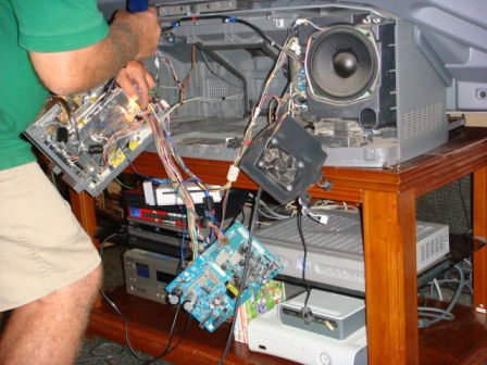

And to answer your other question, I would not consider this a typical do-it-yourself project, but it is certainly possible for owners to dismantle their own TVs to get to the optical block. I have posted some pretty detailed pictures and procedures on my web site:
The only real tools you will need are a conventional Philips-head screwdriver and another Philips-head screwdriver with about a 10" shaft. The main thing is to be VERY careful, and to carefully note where the parts and specific screws go, and to carefully label any wires that must be disconnected. The pictures and instructions should help, but each model is a bit different, and there are a number of things that could go wrong.
A repair shop would probably charge about $350 to do this (the same labor charge as replacing it).
However, pretty much your only option once you get to the optical block is to blow compressed air into the opening that contains the LCD panels (you can see this in the pictures), and there is no guarantee that this will even work. I have heard varying reports of success--usually this is not successful. You may just redistribute the dust. And even if it does work, or at least makes it better, the problem is likely to return.

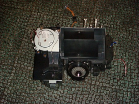

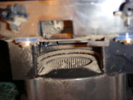

...My KDF-70XBR950 is now repaired..Thanks to Sony....The new optical block looks just like the old one, so the improvements they made are on the inside and not visible..I had dust, which burned up the LCD's...My tech who did the repairs said these TV's are really very good despite the optical block problems..He also said many other brands are having the same problems and are not being repaired by their companies...Sony is the only one to do out of warranty repairs or exchanges...My picture is now back to fabulous..I am happy Sony stepped up to the plate to correct this...At times they were a pain in the butt to deal with..I am feeling better about Sony, they did not let me down..I might buy something else from them now...Enjoy the pictures....

Congrats on getting your TV repaired, it's always so nice after having to deal with the blue blob for weeks or months. I haven't done any research about other manufacturer's TVs having similar problems, has anyone else out there heard anything about this or done any research about major problems with other manufacturer's rear projection TVs?
Thanks for the info about the apparently unchanged outward appearance of the optical block. I'm not overly surprised that any changes they made, if in fact they did make design changes as claimed, are not visible on the outside. The Optical Block has to fit into the exact same tight footprint which would severely limit any capacity for external changes. Best guess (and that's all it is) is that they changed the fan design, fan power, or altered the air flow in some manner to achieve a greater CFM and thus increase the cooling capacity. I think Sony would probably do their best to keep the change(s) under their hat, since by making the exact change known it would probably be obvious to most people that this was something that should have been caught and changed a long, long time ago.
That's a lot of dust on that part, is that the Optical Block or some other component? I presume it's the Optical block but it's impossible to tell with such a close up picture. I really wish I had asked the tech to let me take some detailed pictures of both my old and the new optical blocks when they recently repaired my TV, but unfortunately all I could think about at the time was having my TV fixed and like new again. If anybody out there is still waiting for their optical block to be replaced, it would be great if you could take several good pictures of both optical blocks when they effect the repairs. Try and get pictures from the same distance and angle of both parts so that a detailed comparison can be made.

The extremely dirty fan shown in Frank Connors' middle photo is the centrifugal fan that sits directly on top of the optical block. It is directly under the circular area of the gray part seen in the photo above it. This fan appears to suck air from the LCD panel area (on the right side of the top photo) and blow it down onto the lamp (lower-left of the top photo). That is a huge amount of dust, and it is not surprising that there was dust in the LCD area. You can see more detailed pictures (with a much cleaner centrifugal fan ) on my web site:

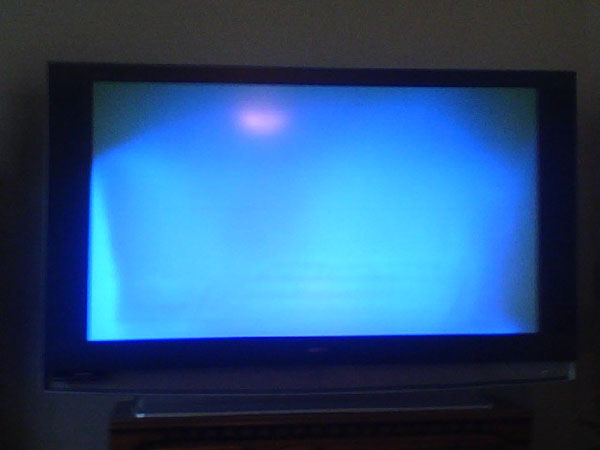

Our screen looks alot like that posted above by Navarro, except it has an approx dime sized white/light mark in the center with an upward directed beacon or strobe - kind of like a giant V. It doesn't matter whether there is or is not a device etc - same appearance - we can't change it from the solid screen appearance regardless of what we do (other than turn it off).
When we first turn it on, there are very distinct thin, horizontal multiple colored lines across the screen that fade within a minute or two and the screen starts off darker blue at the bottom then lightens a bit all over and forms the beacon type appearance in the center after another minute or so. Nothing we do changes this appearance at all.

It definitely sounds like you have a variant of the "blob" problem, with the source being the Optical Block. If it's at all possible for you to post some pictures that would be great, but you're definitely going to need to get it examined by a Sony authorized tech. before anything else can happen.
Yours is the first KDF-E50A10 that I've seen mentioned in this forum that potentionally has the blob type of problem, so that's another reason I find it unusual. It may also be the first reported mid-2005 or newer rear projection Sony which potentially has the problem (at least that I've seen). There have been a few other owners of that model that have reported other misc. unrelated issues, but none with the blob defect.

Eric D & Steve, Yes in fact the fan was replaced..It is part of the entire Optical Block that was replaced...A small electronic board attached outside of the optical block was also replaced...There was no dust on my LCD's (that I could see) it was burned and cracked due to the large amount of heat build up caused by dust in the fan..proper air movement was decreased due to the dust and no way to properly cool the heat from the lamp..
I hope this makes sense....This is my take anyway and what the tech found....I would have to say a better cooling system design & dust filter would be a way to solve this....I think........Also there is just no way of cleaning this...My tech said only replacement of the optical block is the cure....Like I said before, I am now repaired...The picture is Great, Just like new...But my warranty is only 30 days labor & 90 days Parts...Almost as much time as it took me to get it fixed....Sony really needs to work on that 7 year thing.......
