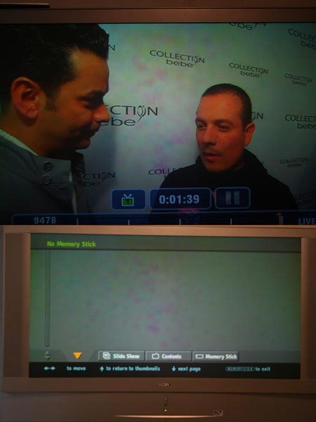

I recently had what appears to be a green "etch-a-sketch" appear on my Sony LCD projection, model #KF-50WE610. I have attached a picture of what I see on my screen. Can this be solved by changing the bulb? I have a spare XL-2100U bulb.
Any help would be appreciated!!
Username: Slinke
Post Number: 9
Stephan, there is currently no picture attached, but this sounds like the scribble/random line issue, requiring replacement of your optical block. This is covered by a Sony extended service bulletin, even if it is out of warranty. See my web page for more details:
http://splinke.googlepages.com/sonyrearprojectionlcdtv-opticalblock

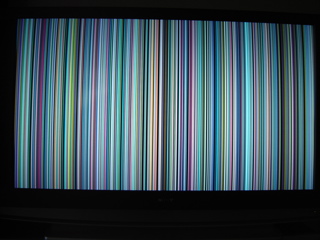

I have a KDF-50we655 purchase 6/2005 and am having problems as well. I have purple fingerprint like dots apearing on the screen. I took the tv to an ASP and they diagnosed it as a optical block failure. However, he checked with sony and since it is not blue star/blob or road mapping it is not covered. Has anyone else ran across this problem? Also would you all recommend pursuing this further with sony. I talked to 1st and 2nd level customer support but got the "sorry sony will not be able to assist you" line. The ASP said it was definetly an optical block failure. Any suggestions would help thanks.
Username: Edenney
Post Number: 10
If you could, please post a picture or two of your TV here, taken against a background color that shows off the problem well. Sounds like it's certainly related to the same core defect, even if it's manifesting itself in a slightly different way on your TV. If we saw pictures it would almost certainly be obvious.
In any event, if it's the Optical Block as it surely is, and the problem is similar to everyone else's, you will almost certainly get some measure of justice at the end of the day. Most likely a new Optical Block fully covered, you just need to stay after it and write letters to the right people. Look back at some of the recent posts for more information.

Username: Slinke
Post Number: 11
On a related note, since I had a 2004 model with the blue haze/blob problem, Sony covered my repair in full by a Sony authorized repair center. However, the first optical block they sent was for the wrong TV, and then the second optical block was defective (colored vertical lines, see attached picture). The third block finally worked, and hopefully will continue to work longer than two years.
After the first screw-up, the technician put my old optical block back in when he realized the new one wouldn't fit. Then, I waited a couple of weeks due to the optical block supposedly being on back-order. And, after putting the defective block in, the technician did not have time to put my old one back in (at least it was viewable with the blue haze/blob--the colored bar made it unwatchable). Fortunately, the third block came in in a few days, so the TV was only non-functional for a week.
Defective replacement optical block (colored vertical lines):
