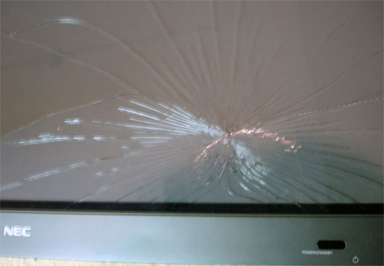

Hi, I have a NEC Plasma screen. It's broken, and I was wondering if it was possible to fix it. I know I can replace the glass pretty easily, but when I power the unit, the power light comes on, and I hear it running, but I don't see any display... Is their ANY way to fix this? How expensive?
Username: Gamicalguy
Registered: Oct-04
Like when I turn it on, the power light goes from red to green, and it makes a high pitched buzzing noise, and then nothing, and then it repeats the high pitched buzzing noise like its trying to start again.

Sorry for you.
No use in trying to repare it. Will be to expensive.
How on earth did this happen?

Plasma screens work like flourescent light bulbs. Break the glass, the gas escapes, and you replace it. Broken plasma screens are worth the value of the electronics and power supply, which is to say maybe $100. Plasma screens are basically disposable items: when they break or burn out the entire screen must be replaced.

You may, in fact, be able to replace your cracked plasam screen. Don't ask, but I also managed to crack my front glass like Brennan's NEC. It is a Panny TH42PX50U. Panasonic support, along with all the web postings I saw said I was screwed and would amount to buying a new one!!!
In my case, it was just the front glass and DID NOT penetrate to the next section- the main guts of the panel. Basically the same as having the star and long cracks on you windshield. The TV worked fine but had cracks runnig throughout. Being persistent I called several authorized service centers until one said they never replaced one but belived it could and gave me Panny Parts not Cust Service. Parts put into the research group who called back and said it could for around $600. Got the part, had it installed and as good as new. Not cheap, but $750 (after repair charge) compared to another 3 grand was a bargain!

well, once the vaume is broken on the plasma its pretty much junk. You can buy a new plasma tv from plasmahouse.com a really cheap price.
Unregistered guest
All plasma displays are constructred somewhat like a standard crt [cathode ray tube], in that they are a sealed glass envelope under a vacuum.
But a regular crt is a much thicker design and will take being hit [on the face], such as a bouncing baseball,etc. I have seen a crt hit hard enough to cause the shadow mask to become dislodged, resulting in poor color, but still work ok in every other way. The sealed glass construction of a plasma display is much thinner and cannot be bumped or jarred, without cracking it, which results in a loss of vacuum and a worthless display that can only be replaced as a complete assembly. So when there is a cracked display, all you have is junk. Most plasma displays approach the cost of a completely new monitor, which is why an lcd or dlp monitor [more physical durability] makes more sense, overall.

About cracked front glass on plasmas your being given VERY BAD information. People! Do not listen to Ron Tozier's posting on Aug 31 or any others that state the same doom and gloom. Read how I had my screen fixed from my July 27th post.
As for that loss of vacuum statement- that is a complete myth- at least as Panny's go and can't believe there is such a different construction by other MFGs. There is no vacuum involved between the front glass and the actual panel behind it! I know I watched the repair techs disassemble the whole TV in my house and there is just a foam gasket to prevent dust from getting between the panel and the froant glass- end of story.

I had the same idea but my crack was to big and many of them and had the glass replced. I don't think it would do any more damage to try it and if it doesn't work and the nick is in a prominent location get the front glass replaced. See my previous post.
