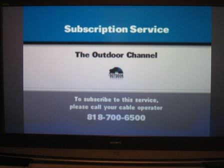

Username: Rkresha
Registered: Jan-07

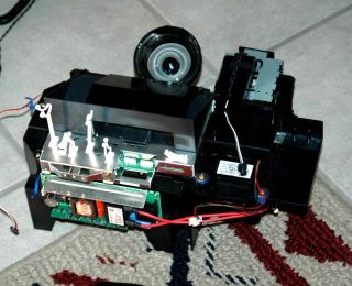

My thanks to those of you who have posted, it saved me from thinking I had to buy a new $3600 TV. (I have a Sony KF-60WE610 60" rear projection) I had the "roadmap" problem and because I knew what to call it, I was able to get it replaced free from my home theater dealer [Bjorns - San Antonio]. It took a couple of hours to replace and it took a week to order the part - and it was out of warranty for almost two years... It was a local store and they have earned my business the next TV I buy. I am uploading the pix of the problem and the optical engine so you can see what the guts of the TV looks like.

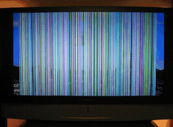

Username: Rkresha
Registered: Jan-07
Here are the photos for above post - it took a while to get it small enough for acceptance.Upload
Username: Rkresha
Registered: Jan-07
I wanted to pass along a couple of things the technician mentioned. I watched him repair it (I used to be a technician as a teenager) and as you can see from the picture in my previous post, if anything gets on the little "eye" on the top of it (actually it is the projector lens), it will cloud up the picture. It could be smoke, pollens, dust, humidity, etc. He also mentioned that the rear projection LCD's actually have a b&w picture and then it uses a "color wheel", not unlike the old film projectors to throw the colors up on the screen. If anything goes wrong with this (it is part of the optical engine and mechanical)you have a sucky picture and a sizeable bill. He conjectured that this is one of the reasons why the manufacturers are moving away from rear projection to non-mechanical system. It is just too bad that right now, rear projection is the cheapest way to get a good, large picture. But, technology marches on!

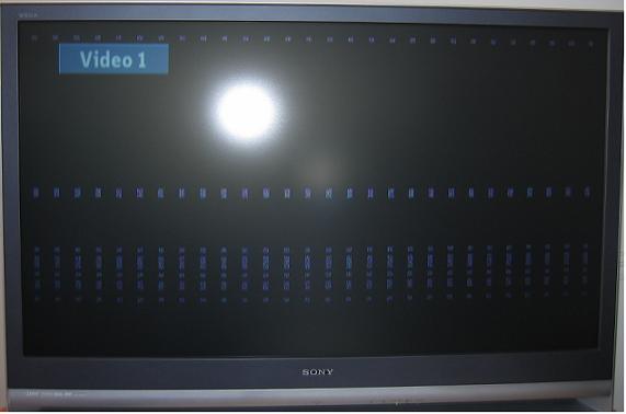

I have the kdf-42we655 and have the bluish portion on the bottom of the screen. What was it that was the problem with this symptom? I called sony, they said that its not covered because its not under warranty, but this was prior to finding this site. I plan on taking it in to the service center and talking to them. Again.... what was the problem found with a bluish tint on portions on the picture?

Username: Catchvijay77
Model Number:KDF-E50A10
Serial Number:8528059
Purchase Date:04/15/06
TV manafactured: March 2006
Problem: line blocks appeared in the bottom portion of the screen and appeared all over the screen.
Attached the pics of the problem
This TV is 10 months old and I have the above problem. After paying so much for a brand name TV, I didn't expect this to happen.
Since I had the protection plan, the technician looked at the problem. After doing several tests (B-Borad C- Board etc...) , the technician finally decided its a problem with the B-Block and it needs a replacement. However, he was n't sure what would have caused this problem. The technician has ordered the parts from Sony and he is coming next week to replace this part. Though he is going to replace the B-Block, i'm just worried what the gaurantee that this problem will not happen again..This pushes the buyers like us to get additional protection for many many years.
Then today I called up Sony Customer Service, they took all the details and gave the nearest Sony Authorised service centre to make an appointment (since the TV was purchased less than a year). I'm waiting for the Sony Technician to come in and take a look and see what the cause of this problem. Is it a manfacture Defect? or is it something caused by high-frequency video Signal -its unknown ..???
Thanks for all of the guys who are sharing the information on this forum.
If anybody has ever faced this problem, please post the message in the forum and we can see what can be done taking up this issue with Sony folks.

Username: Oninunderwater

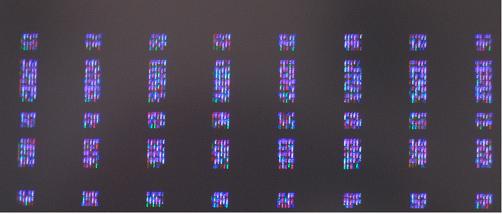

I have a 3 year old KF50WE610 with the color vertical line problem. I took a picture of the problem into the store I purchased it from, a major internet A/V dealer that has a shop in town here. The technician looked at the picture and immediate said it was a DIC Board, a $775 part. Is this a B, C, or D-board? Has anyone correlated the color vertical line problem (see picture) with the replacement of a specific part? If so, has anyone had Sony replace it for free? The technician said I should start with a call to Sony 800-222-SONY and open a case. Has anyone tried this tactic with any success?
Thanks for the input!

Well tomorrow is the day. The Circuit City tech is coming to change out the optical block on my TV. Hope it go's smoothly, will post update on service tomorrow. wish me luck.

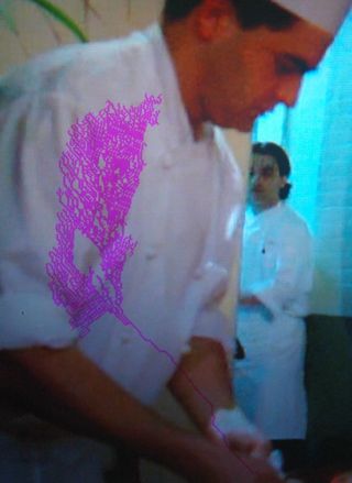

KDF55WF655 made Nov 2004 with blue blob on screen. Upload
Username: Rhood
Hi
All looks good now,It took the tech 2hr to change out the optical block. Time will tell. I would like to thank all of you for your help and I hope you all get your problems solve too. I think Sony should make good on these defective sets as they should last many many years without problems.
Get Her Done Upload

What's your opinion on this issue with my Sony KDF-55WF655. I have had it 2+ years, it's used all the time. It has been an amazing TV. I made up this little website and sent it to Sony, they sent me a list of local service vendors. I spoke with one of them, who couldn't download my video but said based on your info, I think it's the lamp that has to be replaced. the XL1200 or something like that? The Sony service guy will charge me the same rate at the sony store plus $65 to install it. He also mentioned that you can't reset the lamp counter yourself. Some designer wasn't thinking there. Why have a self service part and then you can't reset it to zero?
Anyhow, please check this out and let me know. Thanks so much.
www.tvl.com/sony/untitled.html
I am technical guy, so I have done 99% of the diagnostics myself so far.
