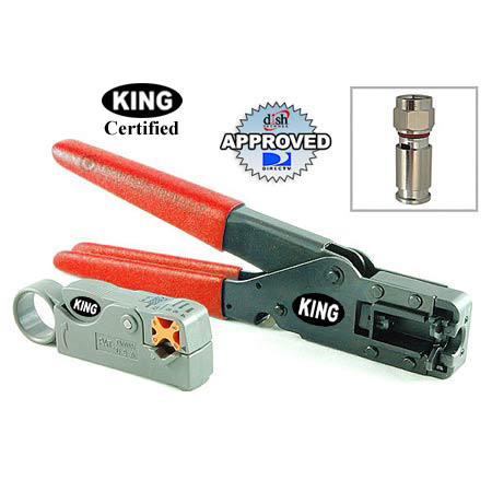

- Same issue with compression connectors, snap and seal. Great weather resistant. Less problems
- Ground your metal coupler, splitter or DISEqC switches etc.
- Your connection will last you 50 years good for all weather condirions.
