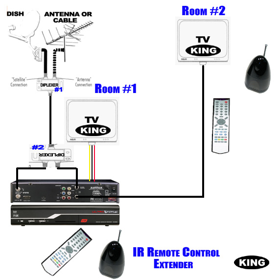

One simple way:
- Run a second coaxial cable from receiver.
- You need to use a Jensen IR remote extender
How to share and change thru channels with one Single Receiver
Requirements:
- Wireless IR Remote Control Extender about $25
- You can use same remote, or extra remote control
- One Coax cable out from Receiver to 2nd TV Set
IT WON'T BE HD BROADCAST ON SECOND TV SET
It will let you change remote and all features in your Receivers
IR Signal will go thru the walls and up to about 100 feet
It will be same program on both TV sets
You can also use extended remote to share Tivos, DVRs, VCR etc.
