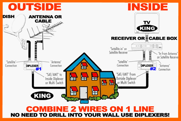

Hope someone can help. I have DirectTV and had added an antenna attached to the dish to receive my local channels in order to save a couple of bucks. They link together by the dish on the roof and both come into the house on just one cable. All I had to do was turn the dish off and I could use my local channels thru my vhs unit.
I now went out and purchased a Toshiba HDTV flat panel tv. I can get the dish stations installed, but can't get the locals. Also for some reason, I can't receive the locals on my other tv's that are split off.
What am I doing wrong? Is there some way to pick up my local stations on that same original cable? Do I try running a seperate cable from the antenna mounted on the dish? Sorry for such a long question - just call me frustrated and HD ignorant!
Thanks for the help

The Satellite/antenna combiner is known as Diplexer. You need 2 of them one outside the house a second before your DTV receiver. This diagram can be helpful to you.
You are correct in SD Satellite receivers you must bypass antenna by switching Receiver off. Some HD receivers you can get it along with your satellite EPG without switching off.

The diagram may work but depends what system you have.
If you have a Directv H20 or HR20 receiver and 5LNB dish, you cannot diplex the signals in that manner.
It can be done, but without knowing what type of receiver, dish (3 or 5 lnb) and if there's a multiswitch, cannot give you a precise answer. Need more detailed info on the whole system

You got a great point
I will look into that. I never tried it on DTV 5 Sat. It is a possibility internal DISEqC Switch by DTV blocks certain frequencies.
One thing I can assure you if you use a diplexer frequency range 900 MHZ to 2400 MHz it will be handled correctly. Cuz DTV or any other satellite company average 12GHz down convert by LNB to 2 GHz max 2.4GHz which is also max that any RG-6 quad shield cable can handle.
To make sure it will work:
- Use 2400 MHz Diplexer (2.4GHz)
- Use RG-6 Quad shield with snap and seal crimps
- Diplexer must be after DISEqC switch not before
But I will tested with my next door neighber he is got the new 5 SAT HDTV system.

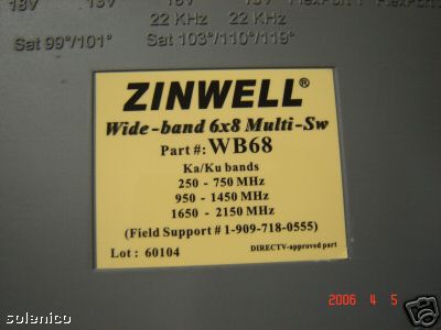

With the Directv 5LNB system, they are down converting to 250Mhz. So that interferes with the UHF television signals when sharing a cable.
There's a B-Band Converter supplied with some of these systems.. Directv normally wants it at the rear of the sat box. But if it is placed between the Diplexer and the Zinwell WB68 Multiswitch, (with the other Diplexer at the Sat box), it will work.

It can't be 250MHz it is too low
Video signal for satellite usually over 900 MHz
It is called wideband multiswitch because it handles variety of bandwithd
Both Ka/Ku
ka is for for audio satellitte
Ku is for Video satellite
AT9 MPEG-4 Ku/Ka dish
http://forum.ecoustics.com/cgi-bin/bbs/show.pl?tpc=2&post=961931#POST961931
They do use 1650 to 2150 MHz
As well as 950 to 1450
I honesty don't know what 250 to 750mhz for but I will have to guess for Audio
They use multiple bands switchings for multiple sats due to vertical and horizntal polarity switching as well as 0/22Khz and 14/18 VDC DC componenent.
For all those reasons it may not be a good idea to cascade with any other type of switch or diplexer. I don't blame you.
But do you know something they may have a special diplexer that will work with this Zinwell. They can't take away the option of adding Antenna and diplexer is the only way to combine.
Also there is a switch on receiver from back you may consider switching to either ch-3 or ch-4 this may hold the trick. for all people that can use diplexer the above diagram is how to.
