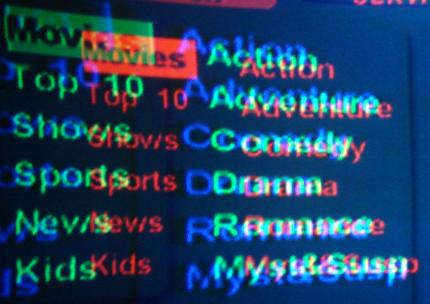

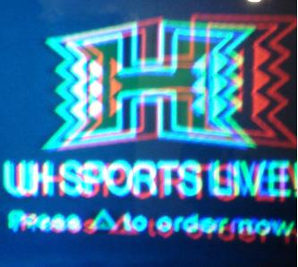

Hello Everyone,
My widescreen 1yr or 1 & 1/2yr projection TV model# (KP-96WT510) has a distorted images and the red, blue and green colors are offset or needs adjusment. Waited 30mins to do flash focus and also tried convergence settings and nothing works. I know I still have ext wrnty but I want to check w/ anyone who can help me on whoever had this problem right now or in the past..
I NEED A REAL BIG HELP PLZ!!! I Attach a picture just so you see my problem.. Believe it or not, I took it w/ a sony camera too which I'm hoping it would last.. PLZ REPLY ASAP, ANYTHING CAN HELP RIGHT NOW!!! Thank You in Advance....
UploadUpload
Username: Bmbutler
The problem you are having is your convergence. Just had it go bad on my TWO YEAR OLD Sony KP46WT510. Told it could cost up to $500 to fix. What makes me mad is I thought I was buying quality! The tech told me that normally rear projection's don't start having this problem until 3-5 years.

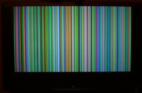

Username: Kennytran
I have KDF-55WF655 has an exactly same problem as John Smith posted the imaged above. Warranty just went out 2 weeks ago. That's piss me off. Why SONY is not recall all of these problem? Quality first before the brand name goes on???.
Username: Kennytran
