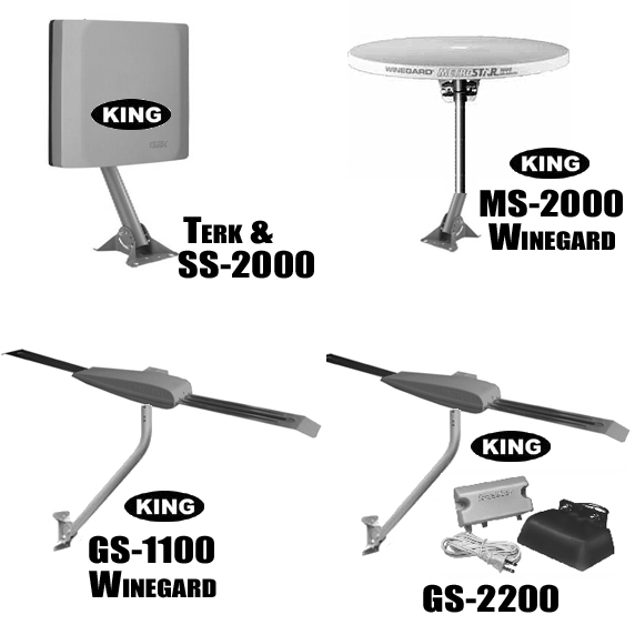

Username: Tapeman
Post Number: 614
$20
GS-1100 - Non-Amplified
Winegard GS 1100 Sensar III Digital Ready Antenna System (GS-1100)
Non-amplified, is recommended for reception in metropolitan areas up to 25 miles away from transmitters.
$60
GS-2200 - Amplified
Winegard GS 2200 Sensar III Digital Ready Antenna System (GS2200)
Amplified antenna is recommended for areas 10 to 55 miles away from transmitters. Includes 117 VAC power supply, easy-to-install mast clamp assembly.
$75
SS-3000 Winegard Sharp Shooter VHF/UHF Antenna
The Winegard SharpShooter™ SS-3000 is the antenna designed specifically for indoor HDTV signal reception.
$80
Winegard MS 2000 Metrostar Omnidirectional Amplified TV Antenna (MS-2000)
Omnidirectional for install-&-forget convenience; no rotator system needed, built-in preamplifier to boost signal strength—up to six times the received signal on VHF, nine times on UHF. Easy to install with hand tools on any antenna mast or light-duty antenna mount. Includes antenna, power supply, 50 75 ohm coaxl cable, 6 TV set cable, hardware, mounting bracket. Good companion for digital satellite systems.
Recommended places:
Circuit City, Frys, Radio Shack, Best Buy
http://www.solidsignal.tv/prod_display.asp?PROD=ANWGS1100&xzoom=Large#xview
http://shop.willyselectronics.com/browse.cfm/2,15.html

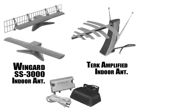

Username: Tapeman
Post Number: 615
I only recommend outdoor Amplified
If Outdoor is not an option some indoor Amplified like:
MAKE SURE YOU SEE THE WORD AMPLIFIED

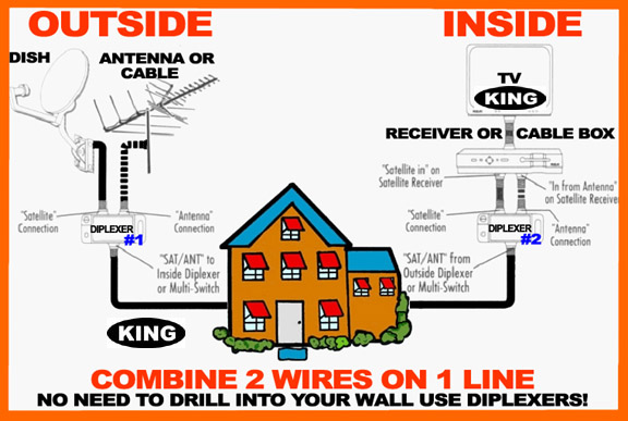

Username: Tapeman
Post Number: 617

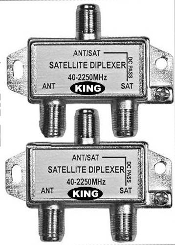

- Your DISEqC switch is safe to operate with the Diplexer (out from DISEqC to Diplexer) it will direct High Frequency Satellite to satellite port and and Antenna to Ant port.
- You can combine any coax signal with satellite via Diplexer

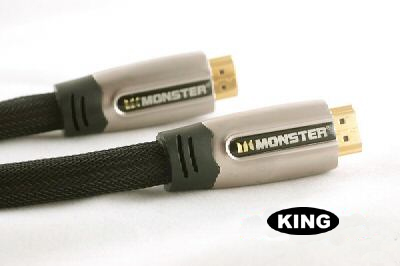

- You don't need an HDMI cable this is just for cable boxes or HD DVD players

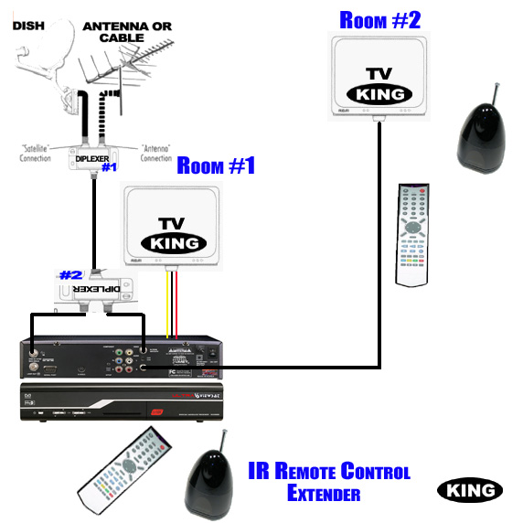

Username: Tapeman
Post Number: 624
How to share and change thru channels with one Single Receiver
Requirements:
- Wireless IR Remote Control Extender about $25
- You can use same remote, or extra remote control
- One Coax cable out from Receiver to 2nd TV Set
It will let you change remote and all features in your Receivers
IR Signal will go thru the walls and up to about 100 feet
It will be same program on both TV sets
You can also use extended remote to share Tivos, DVRs, VCR

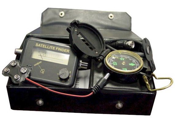

Username: Tapeman
Post Number: 626
Correction correction correction
On one of the link I gave willyselectronics they have GS-1100 as an Amplified antenna. This is their mistake. Specs I provided straight from the Wingard manufacturing GS-1100 is not an amplified antenna this is why it is only less than $25. It is not my error
Here is a little bonus for you

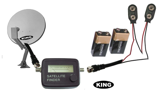

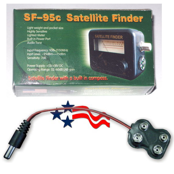

HOW TO MAKE YOUR OWN PORTABLE POWER FOR SATELLITE FINDER:
Materials:
- (2) battery snaps (9 volt) $0.49 Radio Shack
- (2) 9 Volt battery
- (1) coax cable (1-connnecter, other side bare wires)
- Soldering iron + solder (0.99 cent store)
- Satellite finder ($9 from e-bay)
Procedure
- connect 2 wires (1-black & 1-red) from both snaps
- Connect single remaining red wire to center coax wire
- Connect single black of battery snap to silver shield
- Each connection must be soldered using iron+ solder
- Cover each connection with with electrical tape
Purpose:
If you are up at the roof no need to connect to receiver or DISEqC switch to test satellite. No need to pay $50 for a good satellite finder. King's simple steps will let you do it for couple of bucks
King

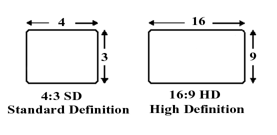

In this small section you can learn everything you need to know about HD and SD.
And please trust me these are best simple explaination on earth by King Tapeman.
Not every 16:9 aspect ratio is HD
Pixel resolution plays big roll in picture quality
A typical HD pixel resolution will be 1080 x 720
A typical SD pixel resolution will be 720 x 480
Some of the pixel resolution available today:

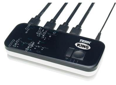

All simple HD connections to your TV

Username: Tapeman
Post Number: 652
I found this item for about $20
2 other great options for easy Sat Finders
Username: Tapeman
Post Number: 653
Or this which comes with dual battery snap

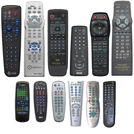

So you got a mess like this:
Well read King’s recommendations and count on me to solve it for you

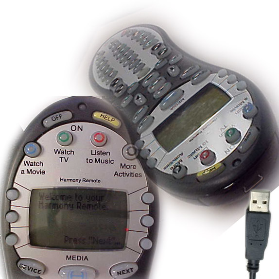

Smart universal remote with LCD screen controls up to 15 components, such as TV, cable boxes, Satellites, TIVO/DVR, VCRs, DVD players, DVD recorders, CD players, game consoles, projectors, monitors, amplifiers, stereo receivers, computers, Ceiling fan, household appliances and much more.
Easy online setup: Configuring your remote to control all of your components is as easy as loading a BIN PGM with online wizard. Just connect your Advanced Universal Remote to your PC or Mac using USB cable that usually comes with, answer some basic questions about your components, and you’re ready to go. Plus, You can even specify which keys to assign to. If you own a Microsoft Windows XP Media Center Edition PC, there is a feature that enables you to integrate your PC with your entire entertainment system.
Username: Tapeman
Post Number: 677
Be smart shopper these devices can be ridiculously expensive. I paid only few bucks for mine I can’t tell you from where. Start today to investigate this new product. There are the 300, 400, 500, 600, 700, 800, 900 series by Logictech price is higher for higher models. So read about each one’s feature before you go on line and order one. Ask me or others in a different thread. If you ask me here I won’t answer at all. Just create a new thread and ask anything you want. I also want few others to take part of this awesome product.
Username: Tapeman
Post Number: 679

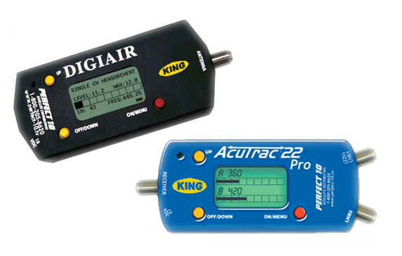

If you do a lot of both antenna and Satellite installations and can afford these 2 meters they are great tools to have.
Acutrac 22 Pro (usually about $150)
Alignment Signal Meter/Satellite Finder
Has a self contained battery
Great to easy find HD and foreign signals, 2 LNBs and 22k Hz pulse tone.
DIGIAIR OTA (Antenna meter) usually about $100
Off-air signal strength meter for digital (SD/HD) ATSC and analog NTSC signals with channel selection.
Easy to use! Simply attach your antenna and select the channel to optimize with the up/down buttons. The signal strength will be displayed instantly.
Frequency range of 47–862 MHz

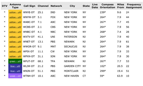

Username: Tapeman
Post Number: 716
The Following will consist of Several posts
The purpose is to know how to calculate AZMITH for your HD/SD antennea OR as in any Satellite:
AS AN EXAMPLE

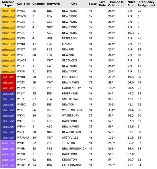

Let say you live at Flushing NY 11356
First check survey at http://www.antennaweb.org/aw/Address.aspx
Enter Your City, State, Zip
Follow simple steps and you'll get DIGITAL CHANNELS:
Username: Tapeman
Post Number: 717
But What about analog channels. Can I still get analog?
Absolutly
Just select analog list and you'll see this:
You can also select both listings as well
Username: Tapeman
Post Number: 718

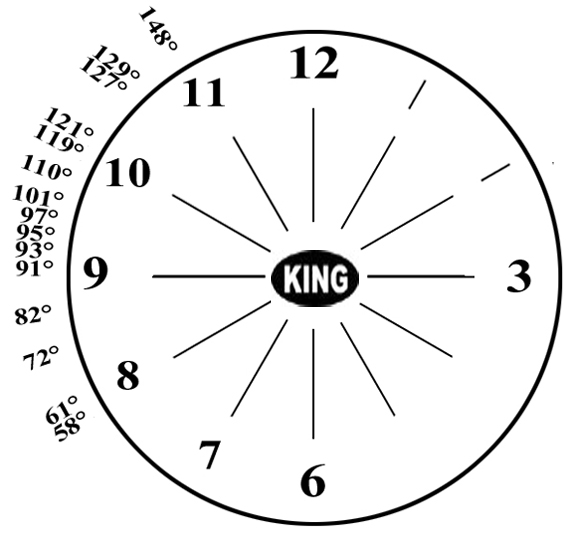

Now the questin is how to select best location to mount your antenna.
Look where it says compass orientation
I will pick 264 degrees where most of broadcast in my home town area
You need to locate true north for reference
Let say as an example:
True north orientation happens to be around 2 O'clock in my area.

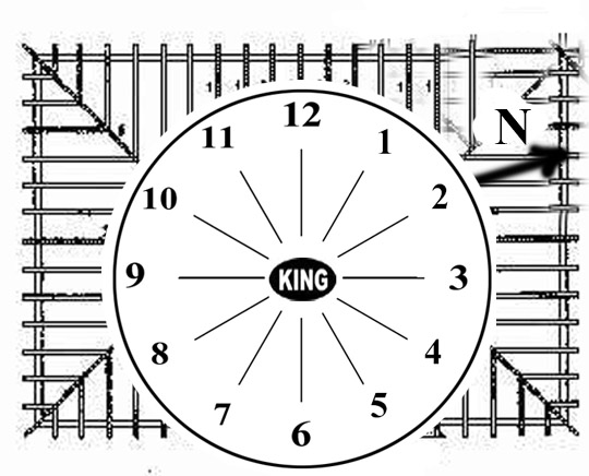

Username: Tapeman
Post Number: 719
My target AZMITH in degrees need to be 264°
What will be best area to mount your antenna?
In this example you start at 2:00 Oclock
3:00 O'clock will be 30°
4:00 O'clock will be 60°
5:00 O'clock will be 90°
6:00 O'clock will be 120°
7:00 O'clock will be 150°
8:00 O'clock will be 180°
9:00 O'clock will be 210°
10:00 O'clock will be 240°
11:00 O'clock will be 270°
Therefore
Best location to setup antenna will be around 11:00 Oclock
Does it matter 10:00 or 11:00?
For antenna not much for Satellite it will matter.
Username: Tapeman
Post Number: 721
Notice that I picked 264 degrees from survey at www.antennaweb.org
You will still be able to pick other channels as well because VHF and UHF uses electromagnetic waves carrying both Digital and analog channels
You may not be able to pickup every single channel due to any man made Obstacles and will vary from one are to another.

Username: Tapeman
Post Number: 723
My true North is still around 2:00 O'clock
Where should I find 91°W orbit location?
Aprox. it will be around 9:00 O'clock orientation
This is how I can count it
You still have to either tweak your dish or use SAT finder.
Not Necessarily you'll always find 91 at 9:00 O'clock.
If let say Your azmith is 1:00 O'clock
Big Deal just start start counting from 1:00.
If you finally found 91 and looking for the other Sats
Rotate the clock after following above steps to reference 91°W as 9:00 O'clock
You have to understand angles or hire a Pro. if you don't.

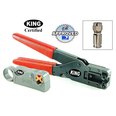

One of the most important factors in any type of installations is WIRING.
I advice anyone Armature or Professional to use Good wiring.
RG-6 Quad Shield is the way to go:
- There are so many different Coax cables Rg-58,59 etc.
- There is also RG-6 double shield as well as quad shield.
- Quad shield is only 5 or 10 cents more per foot.
IT IS WHAT I RECOMMEND.
- Will other cables work? yes they will.
- Best proven product in the market today.
RG-6 (Quad shield). Very little or no DB loss.
Great for up to 150 feet before your DISEqC Switch
- Same issue with compression connectors, snap and seal. Great weather resistant. Less problems
- Ground your metal coupler or DISEqC switches etc.
- Your connection will last you 50 years good for all weather condirions.
This is one good source:
-TechToolSupply
877-20-Tools
http://www.techtoolsupply.com/
This is not where I buy from but certainly shop around.
Please Note that I pick vendors based on their knowledge of product as well as their fair prices, aslo rank in their yahoo and google listings.
I don't get paid from anybody.
Always best if you do your own shopping, use as reference lookup.

HDMI Cables
You don’t need HDMI cable for Antennas to get HD or Digital channels. Just a regular Coaxial Cable.
HDMI will carry both Audio and Video Digital signal
All HD DV Broadcast in 1080i Today
HD formats today like 720p, 1080i, 1080p
HD formats like 720p and 1080i can work with almost any generic cables.
Generic cables won’t work with HD DVD 1080p or PS3.
They simply won’t pass 1080p.
But HDMI 1.30 protocol will work on any Format
resolutions up to 1920 x 1080
1.30 HDMI compatible with any HDMI port. Works for HDTV, Digital Setellite, CATV, DVD, HD-DVD, Blu-ray Players, AV Receivers and Sony Playstation-3.
You’ll notice clear picture & vibrant natural colors even when there are lots of motions in full 24-bit color depth.
HDMI 1.30 increases its single-link bandwidth from 165 MHz (4.95 Gbps) to 340 MHz (10.2 Gbps) to support the demands of future high definition display devices.
Username: Tapeman
Post Number: 750
What should I look for when I buy HDMI cable?
What is the best source?
- 1080p 1.30 (10.2 Gbps)
- If it doesn't have any of that chances are it is not.
- If your TV doesn't have 1080p then any HDMI may work for you.
- Suggest place will be best buy but simply shop around I gave you all you need in this post.
Enjoy the New Technology.

HDMI input connections in HDTV
One of the biggest problems on some HDTV is they make one HDMI input.
If you got Play station, HDDVD, HD Satellite receiver/HD cable. Question are you going to keep swaping? I think they should have 3 HDMI on any HDTV. This is one possible solution to get by until they start making multiple HDMI inputs.
HDMI-31 Switch
Switches when HDMI signal is detected
Connects multiple HDMI components to a single HDTV. Automatically switches when you turn a product on Video Amplifier Bandwidth - 1.65 Ghz Compatible Format Support - DVI, HDCP Resolution Supported - 480p, 720i, 720p, 1080i, 1080p
